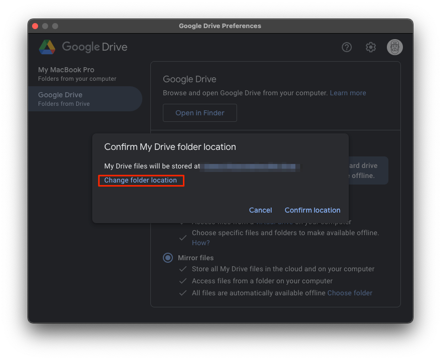

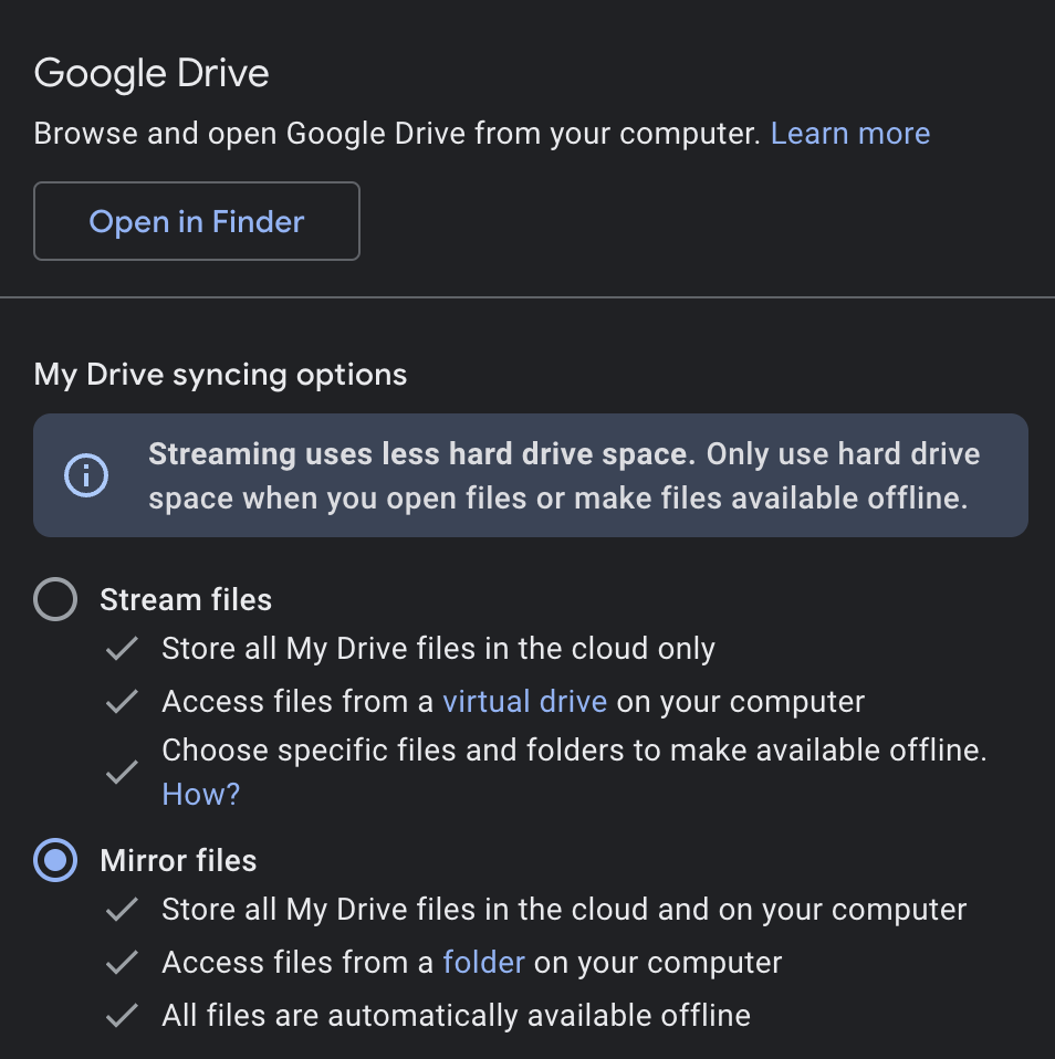

I don't know if this is compatible with your desired workflow or not, but I switched from Stream Files to Mirror Files in settings and Spotlight indexes properly now: https://s3.amazonaws.com/4rk/screen-shot-2022-06-28-09.03.48-846nwtf8.png
Appreciate the tip! But my local drive just won't be able to handle that load unfortunately. Unless.... do you know if I can tell it to mirror to an external drive specifically?  I might have a 2TB laying around somewhere that could work if that's possible.
Well whaddaya know. This just might work.
