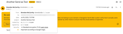

I added SPF and DKIM records to the secondary domain. Still, it includes the primary domain in the Mailed by:
Mailed by: primary domain name
Signed by: secondary domain name
Is the user's primary email address on the primary domain, or secondary domain?
Yes, Primary email address, attempting to send as an Alias configured for the Secondary domain.
Main Account: brendon@r______n.com
Send as Alias: brendon@c_____o.co
SPF, DKIM and DMARC configured (and verified) on both r_____n.com (primary) and c_____o.co (secondary).

I signed up with domainA.com and have domainB.com, domainC and to Z, as secondary domains but the SPF is not from the selective domain , the mail is sent from and always remains the primary domainA.com.
Mailbox shouldn't restrict this. I assume this is how the Google SMTP server work to not allow secondary domains for spf.

Authentication is via DKIM, alias/secondary domains which is correct but the SPF value(mailed-by) remains the primary domain which is wrong. Google Workspace is so advance but can't offer the basic feature. "Send as" alias or unchecked. both get the spf header domainA.com and not the secondary domains, the mail is sent from.

The problem is when i am sending or replying any email from any@secondexample  .com domain, the SPF shows primary domain, mailed-by: example.com while it is sending from secondexample .com
SPF and DKIM is properly set for both domains. It is strange that secondary domain is taking their own DKIM value but using primary domain as SPF which is wrong.
