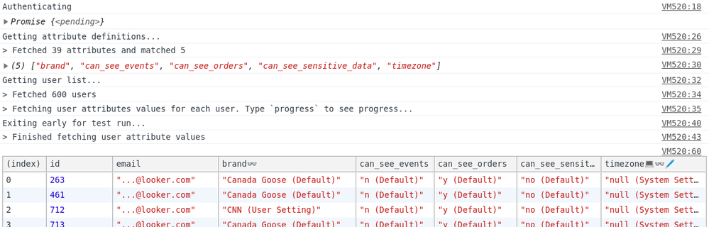

And here is what the output looks like (with emails redacted):
