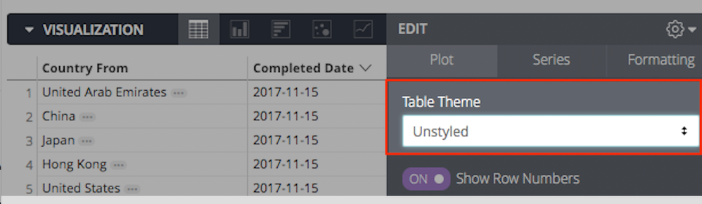

As someone fairly new to Looker, how do you change the background colour of the header bar in the table, however?
From the Edit menu on the right, choose the Table Theme that works for you.

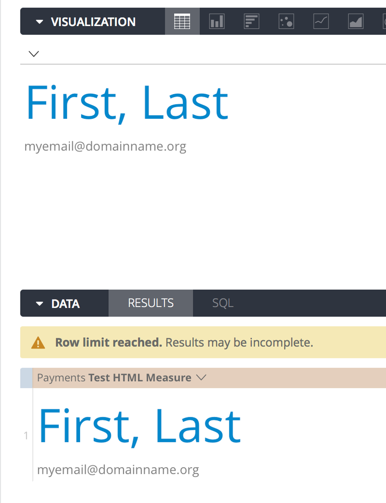

Hi All,
Below html in LookML works fine for “SINGLE VALUE” Visualizations.
html:
{{ rendered_value }}

Added a snapshot
Ah, so in order to be able to specify the size in the html we need to use rendered value, not value? Seems counter intuitive to mean, given the documentation refers to rendered value being the default formatting for Looker, but we can work with that.

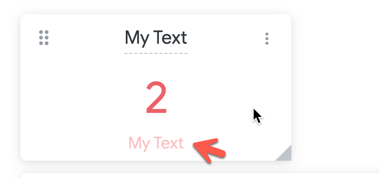

Is there a hack to show the text at the bottom darker than what it shows? i am using a single value look.
Any help is appreciated.
Somehow the title shows opaque with 30-50% transparency i believe, i hope there is an easier way to fix this.
I am also looking for the same. Could not find any solution yet. And I don’t link lookML based hacks to solve these problems. The same measure can be used in different places/viz. So I don’t want to control it in the model.
You’ll want to use html for a single value viz font size change. You’ll take the measure and add html to it for font size, color, text, etc.
