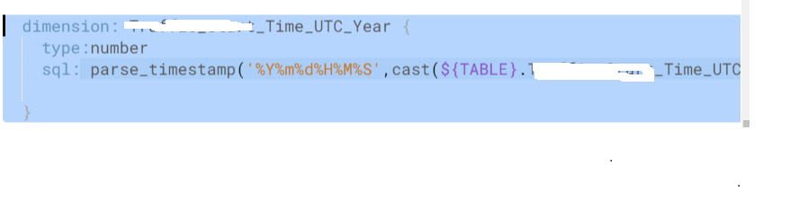

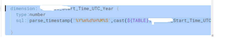

This is the data in my field:

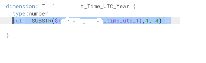

I tried that substr function
but this small expression is failing.
Can you help me to fix this error:

I tried but this is
the new error:
Dawid
Participant V
This looks like your data isn’t always the same, meaning this error shows a value without the seconds, so do you have them all in the same format? if you have multiple formats you may need to use CASE with SAFE.PARSE_TIMESTAMP IS NULL

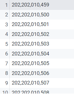

I have used:
This is the result:
Is this conversion fine?
I am surprised to see small letter m and d for month and day, capital M for minute. it should be YYYYMMDDhhmmss.

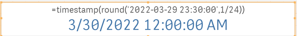

I want to round my field to 1/24, or I can say hour as:
=timestamp(round('2022-03-29 23:30:00',1/24)) is equal to
This will always round the timestamp at hour level and join always work for both tables.
I am struglling how to do it in Looker+BQ.
I know how to do it other tool like Qlik but I am new here, need your help.
Can you please tell me how to round the timestamp by 1/24. 1/24 is the step. When I say step, it means, read below example:
Round(2,6 )
Returns 0. Rounded down because 2 is less than half of the step interval of 6.
In this example, the size of the step is 6 and the base of the step interval is 0.
The intervals are ...0 <= x <6, 6 <= x <12, 12<= x <18...
