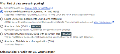

If I try to push the bigquery table directly in GCS, there are following scenarios,
1. If I direct export the table to GCS it is of type "application/octet-stream", which is not supported type for import of datastore as shown below
2. If somehow manage to upload a CSV on GCS and then try to create a datastore using Cloud Storage, it says the following warning as below. As CSV I believe are only supported for FAQs and nothing more,
What will be your suggestion on it? use of JSONL? or any other way?
I'm not sure as this is pretty common use case to import data from BigQuery to Datastore for Agent app. Either I'm over complicating it or is this feature not available at all.

I have created the datastore from Agent Builder. The below screenshot I shared earlier is from Agent Builder Datastore console
As you mentioned, I tried a way around like pushing the BQ table as CSV or JSON from GCS Bucket.
However, this still doesn't work. CSV are only for FAQ data and not for any BQ table content, as mentioned in the below warning on the console,
Also, even when I upload it using the CSV or JSON format I would only be able to integrate it as FAQ under datastore for Agent
and this tool is not working at all when you actually connect it to the agent and query it. Might be because the data I provide should be of FAQ format and is not.

But the above link is providing you preprocessing of CSV for FAQ data only. Which means the that only FAQ data can be uploaded in datastore with the mentioned schema in the link provided.
That is the point I'm trying to make is that if you wanna have any structured type of datastore it could only contain FAQ data and not any bigquery table or other formats.
Hence I'm unable to use the BigQuery tables for datastore in Agent. Below example to just clarify of what possible type of data I might wanna to upload

@ammar_hanif That is correct. At the moment Data store agent only supports structured data in BigQuery in the CSV format  below where title and url are optional.
"question","answer","title","url"
 Reading through the thread I noticed that you mixed search and chat apps. Data stores used by search and chat apps are different and you cannot interchange them. So if you are trying to build a chat app you must create a data store that chat apps can fetch (you cannot use a data store that you had previously created for a search app). @mayurrathicg There are many reasons why the tool is not fetching any data, are you using the CSV format in your BQ table? If so, since debugging a data store agent is easier than debugging an agent app I would try the same query in Dialogflow and check Cloud Logging (or even just the original JSON response in the simulator).
