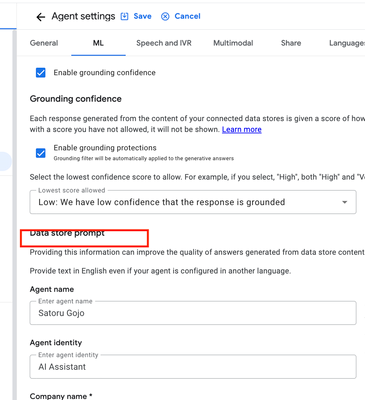

3. Still in the same menu: What is the data store prompt for?

3. This is what I meant for Data store prompt: -> this is just to give context to the prompt and have better answers
What does this do? Is it the default prompt similar to 1?
