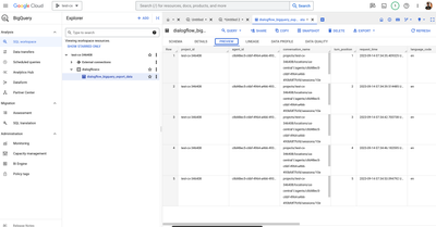

Hi, it worked for me, see the image below. I had to create the dataset in the same region. not using multi-region datasets, check screenshot.

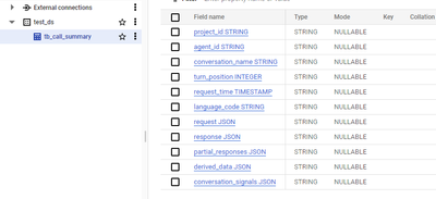

this the table schema.
let me try that out. thanks a lot. much appreciated.

Thanks a lot @xavidop , that was quite helpful. Its working for me now.
The issue was incorrect column names. each column was appended with its type (as seen in above screenshot) as I copied the column names as it is from documentation.
