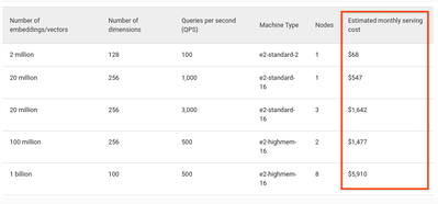

  1. Data Size Calculation - As you mention ~0.0286 GiB was your data size being said this may be categorized to shards_size_small, the machine types that you can use to deploy your index (using public endpoints or using VPC endpoints) depends on the shard size of the index. Based on the image below machine type support you may use e2-standard-2.

1. Once we choose the matching engine for a specific task we are billed for the used resources here are the estimated monthly serving cost.
The estimated monthly serving cost is directly related to the number of nodes used in the console. To learn more about configuration parameters that affect cost, see Configuration parameters which affect recall and latency.
