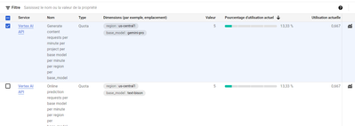

Same issue here,
I am using Vertex AI to generate content. Can you please guide me through the solution?
Here is the quota view:

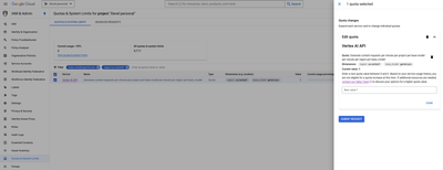

I feel a bit dumb, but... ahm.. where is the quota editing page for gemini???
And yes, same issue as the one above... gemini-pro-1.5 seems to be ... exhausted?

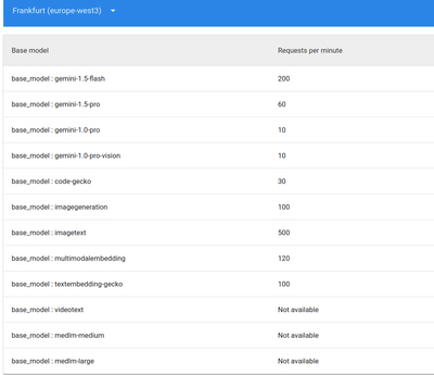

I am experiencing the same error using Gemini-1.5-Pro. We all do not have an configuration error, since for all of us in the Google Cloud Console the hard cap of 5 is set for: "Generate content requests per minute per project per base model per minute per region per base_model"
This should be really easy to verify, that this is not because of calling the wrong function.
Please update the documentation if this is the new Quota or fix the Requests per Minute
I have exactly the same Problem as everyone and this is easily not a configuration/wrong function issue.
There is a hard 5 requests per Minute cap for "Generate content requests per minute per project per base model per minute per region per base_model" regardless of region and model.
Please update either the outdated Rate Limits or use the Rate Limits that are promised on the documentation site:
Maybe you have switched the 1.5-Pro and 1.0-Pro Limits, because the 1.0-Pro Limits are actually higher for me, than the 1.5-Pro Requests limits contrary to the documentation(https://cloud.google.com/vertex-ai/generative-ai/docs/quotas)
