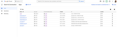

Could you point me to the screen where I can unlink it?
It should be something like this:
Thanks.  I'm familiar with that screen.  I can click through to my 2 data stores from there.  I may be missing something but I don't see how to unlink the data store from there.  Sorry...
