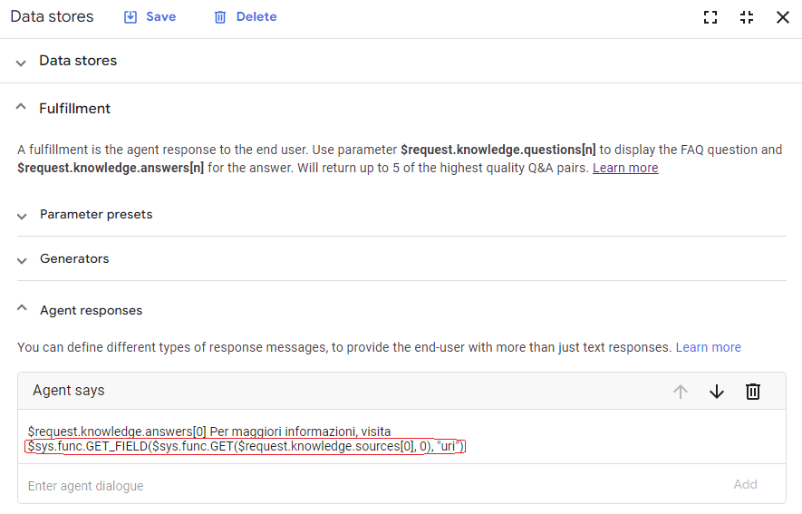

Hi, could you please share how did you achieve that?
I'm also trying to add a link to the response, where I need to add $sys.func.GET_FIELD($sys.func.GET($request.knowledge.sources[0], 0), "uri")?
I tried like this but it didn't work
tried both
and $sys.func.GET($request.knowledge.sources[0])
could you please help?
thank you in advance!
Hi @Timur ,
I've kept the summarization prompt default and made the changes in the 'Agent says' section of the fulfillment settings. There, I inserted the $sys.func.GET_FIELD($sys.func.GET($request.knowledge.sources[0], 0), "uri") directly into the response template. This approach worked well for me while enabling the source link to be both present and clickable in the responses.
Hope this helps!

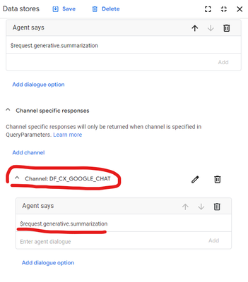

I was also experimenting with summarization, and looks like I found a way to add a link with using it:
but don't forget to add channel specific response (I'm using google chat)
but I still have the problem with link view (if link has spaces):
however I'm glad that link at least showing up, thanks again!
