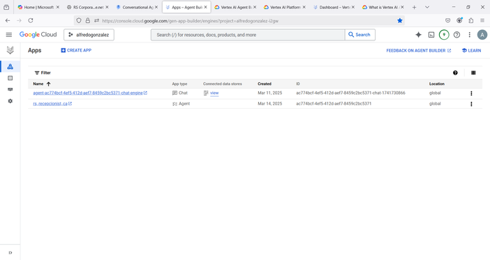

When I check the Apps in Agent Builder, I see the following
It seems like the Agent Builder did not create the right App Type although I followed the steps. Thet Blood Donation Agent is the one I created... I do not have any option to link to the right Application, and hence I cannot finish the lab but also it is not working. Anyone knows how to solve it. I tried to find if there is any possibility to force linking the App Type with the Data Store, using an API or CLI, but was not able to find it. It is not only happening in that Lab / practice. I also experience the same issue in my environment.

The problem was with that lab and similar labs that are outdated. The verification process does not work (I guess the many and frequent changes done to the solution ends breaking some of the labs.
This is a new lab that work: https://partner.cloudskillsboost.google/classrooms/28095/labs/237601 (updated and tested by google on March 12, 2025)
The problem is that there is no documentation or reference (or I was not able to find it) how the Conversational Agent is represented in Agent Builder. It seems the Agent App is dependent of the Chat App that has a weird name (and I did not created). Only the Chat App is the one linked to the datastore(s). I guess this will change in a future release of the solution and the Conversational Agent i created is the only one that will be referenced and will have the datastore linked.
Because the checkpoint in the Lab was not passing and I was not able to corroborate that this is the way it should look like, I thought I was doing something wrong.
