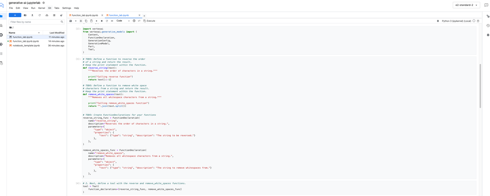

I am having the same issue. I completed the challenge lab and am still not getting the score. Not even the support team could figure this out.Enhance Gemini with access to external services with function calling: Challenge Lab L400Screenshot 2024-10-01 at 12.52.13 PM.pngScreenshot 2024-10-01 at 12.52.27 PM.pngScreenshot 2024-10-01 at 12.52.40 PM.pngScreenshot 2024-10-01 at 12.52.49 PM.png
Hi @sokpara , I hope you're doing well. Have you successfully completed the lab? If so, could you kindly share the solution with me? I’m facing the same issue. Thanks in advance!
