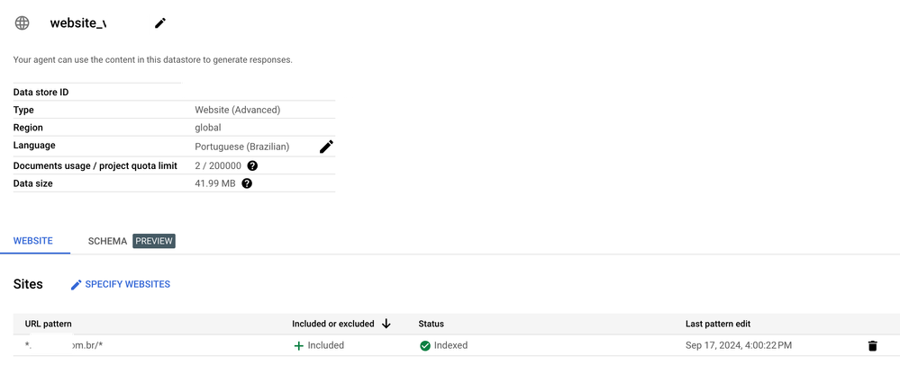

So I have been trying for almost a week now to create a chatbot using Google Vertex Ai Builder (ex "Search & Conversation" feature of Vertex).
I have created a Data Store linking to my website, so that the bot would read my website and respond to any questions from the users with information from the website. The process of creating, indexing and linking the data store to the app have all been successful.
Whenever I use the "Test Agent" function of Dialogflow, however, the bot gives me either no answer at all or "I'm not sure I understand. Can you rephrase your question?".
Any idea of what might be going on and how to fix it?

Hi @fabiodpc,
I understand that you have successfully created, indexed and linked the data store to the app but there's a problem when you use the “Test Agent" function it does not give you the answer intended to the question.
Here are possible key considerations that might help you find the solution to the issue:
  • Check the Data Store Indexing While you mention indexing was successful,make sure Vertex AI Builder can understand the data store and extract meaningful information from it.If you suspect indexing problems, try re-indexing your data store.
  •  Examine Data Structure - The website’s content structure can impact how well the chatbot understands it. Ensure that your website uses clear and well organized content. It will help the chatbot identify key information and relationships within your website’s data.
  • Check Data Store Relevance - The chatbot needs enough relevant information in the Data Store to answer the user's questions. Your chatbot might struggle to find the answer if the website doesn’t contain the specific information the user was asking about.
  • Check Agent Configuration - The chatbot needs to be trained on the Data Store to learn how to answer questions based on its content. Make sure you have completed the training process. Review the agent’s setting in Dialogflow. If Vertex AI Builder can't determine the user's intent from the question, it won't be able to provide a relevant answer.
  • Test and Debug - Test starting with simple and straightforward questions that are directly related to the content on your website. This helps you isolate whether the issue is within chatbot's understanding of the data or with the way you're phrasing your questions. Also try to use a variety of questions to test the chatbot with different types of questions, including open-ended questions, specific questions that require multiple steps to answer.
You can refer to Vertex AI Agent Builder and Dialogflow documentation for more detailed information.
