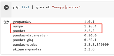

The pipeline logs display an error that looks like a mismatch between numpy and pandas versions. That's the error:
ValueError: numpy.dtype size changed, may indicate binary incompatibility. Expected 96 from C header, got 88 from PyObject File "pandas/_libs/interval.pyx", line 1, in init pandas._libs.interval from pandas._libs.interval import Interval
But I seem to have the correct versions installed: numpy 1.26.4 and pandas 2.2.2. As stated in pandas' doc the versions should be compatible: https://pandas.pydata.org/pandas-docs/stable/whatsnew/v2.2.2.html

Thanks a lot for the reply.
I tried that and it didn't work, unfortunately.
I decided to run the sample notebook as it is in Vertex AI's GitHub (with the provided sample datasets) in a new runtime instance and I got the same error. So the issue is not dataset related and it's likely not something that I did wrong.
