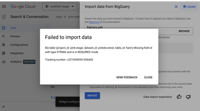

Hi - just trying to import a BQ table into vertex search as a data source, but it's erroring out with the following error:
BQ table (project_id: pink-stage, dataset_id: pinkdocstest, table_id: fiann) Missing field id with type STRING and is in REQUIRED mode
Where my BQ table does have an id field...
any thoughts?

Hi
For anyone seeing this try create the table and set the id to "REQUIRED" mode you can't do this from UI for some reason
So try re-create the table with NOT NULL on the id work for me
Reference https://stackoverflow.com/questions/54465074/revert-nullable-field-to-required for the method
The error message suggests that the vertex search is expecting the id field in the BigQuery table to be of type STRING and in REQUIRED mode. Perhaps your table schema shows that the id field is NULLABLE, not REQUIRED.
