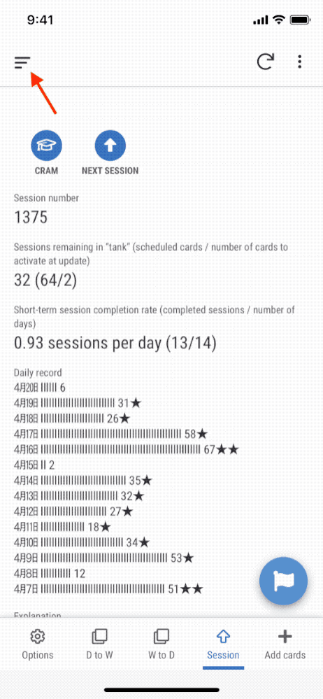

Before I found this thread I posted about an issue I noticed with the new App Gallery configuration. I see now that I should have posted here so Iโm posting more-or-less the same content once again:
The gif above shows some changes that have been made to what used to be the App Gallery. Iโve added some numbers to the video to make it easier to point out what I noticed:
So, it seems that โApp Galleryโ doesnโt have independent content. Is that right?
Thanks!
P.S. When I looked at my app on a students phone today (students copy my prototype app and use it for free), there was NOTHING in the โApp Gallery.โ We had to navigate to โCreated by me.โ However, copied apps are also in โCreated by me.โ Wouldnโt โMy appsโ be better โ just like the editing interface?
Hi Kirk, thanks for sharing! Since many AppSheet app users are also familiar with Workspace app navigation themes, some of these updates are designed to more closely resemble Workspace apps.
Correct, the App Gallery should only show content youโve created or has been shared with you (no more sample apps).
Thanks @Peter ! I appreciate the quick response. I think you answered all of my questions except one: In my gif, the โApp Galleryโ only repeats what came before it, either โRecentโ or โCreated by me.โ So, it seems to me that โApp Galleryโ doesnโt have itโs own unique meaning or content. Is that right?

I appreciate your response and what you wrote makes sense to me. For me, the โCreated by meโ vs. โMy appsโ issue is a minor one and I doubt my users will be concerned about it. What Iโm more puzzled by is what you see in the following image. My app displays โApp Galleryโ where yours does not. Moreover, as I tried to show with my gif, โApp Galleryโ only shows what came before. In other words, if you look at โRecent,โ then โApp Galleryโ will show โRecent.โ If you look at โCreated by me,โ then โApp Galleryโ will show โCreated by meโ content. And, if you are a new user and tap of โApp Galleryโ for the first time, it will be empty, even if you already have an app or two. This is the point is was trying to make.

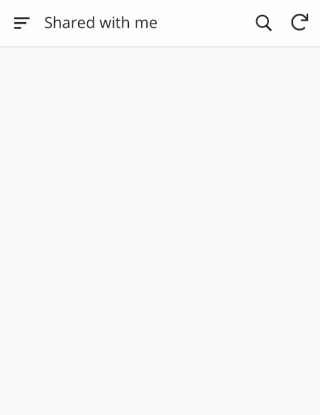

I inadvertently posted this update on how App Gallery is funky in the wrong thread:
One more point about how App Gallery is funky: Iโve noticed that sometimes App Gallery takes us to โShared with meโ though it usually takes us to โRecentโ (which I think is best). Hereโs an example. I logged out of one account:
Then, after logging in with another account, Iโm taken to this:
(Sorry for all of the white space but โShared with meโ is empty so this is what I see.)
โRecentโ would make much more sense.
Thanks for pointing this out, Kirk - think itโs related to unexpected behavior from the โinitial viewโ settings in this app. Will investigate.
