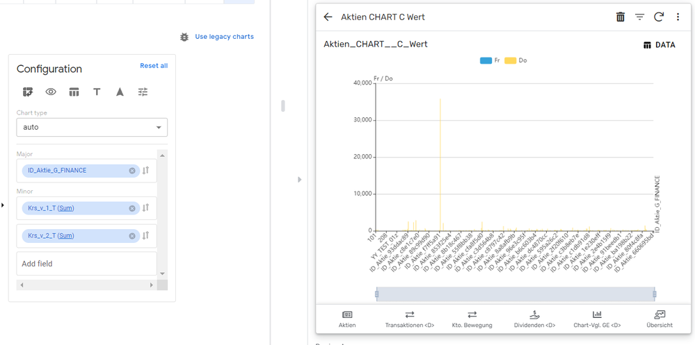

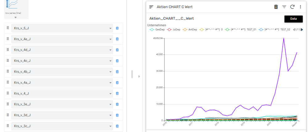

Dear AppSheet Team,
thank you for this new feature. Iโ€™m not sure if I am missing something out. In the legacy version in has been possible to choose the single points from the table columns to be shown in the chart.
That made it possible to be able to visualize f.e. the history of a data (of one single row, the values were comming from the columns). As shown here:
With the new kind of I couldnโ€™t have find a way to make that possible.
As I understand, it is not allowed to pull f.e. single point-data (columns with the values I want to be shown) into the field โ€œmajorโ€.
Major has to be the key of the kolumn. Right?
So with this line chart is just possible to show the difference of different (key) rows to each other. But not to show the line chart of a single row. Or didnโ€™t I just find the way how to do it?
Thank you much!
It looks like your chart type is bar char instead of line chart.
Currently it is set to โ€œAutoโ€ whcih is Bar chart by default, so go there and pick up line chart from the dropdown.
Hey Tsuji,
thank you for your kwick reply. Actually I have also tried with line chart. The problem stays the sameโ€ฆ
I would like to achieve the result where the coumns are set in the major field, not the rows. Is that possible with the new feature?
Thank you
I could be possibly a bug, I suggest you formally report to AppSheet support desk.

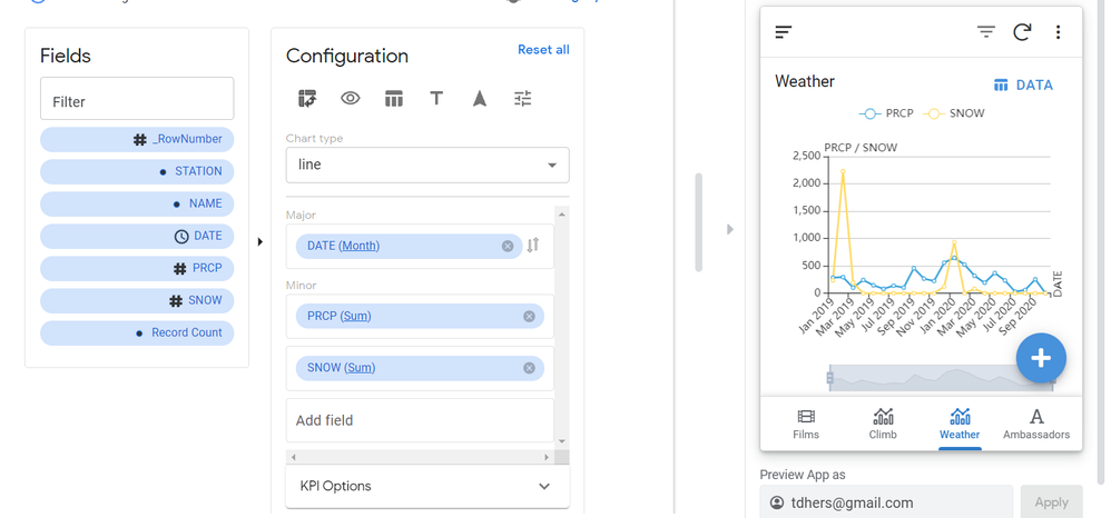

Iโ€™m not sure I understand the issue you are facing.
I just tested it now and was able to add a Time dimension on major and two individual metrics on minor which is similar to your first example with the legacy chartsโ€ฆ
Unless I am missing somethingโ€ฆ
Thierry
