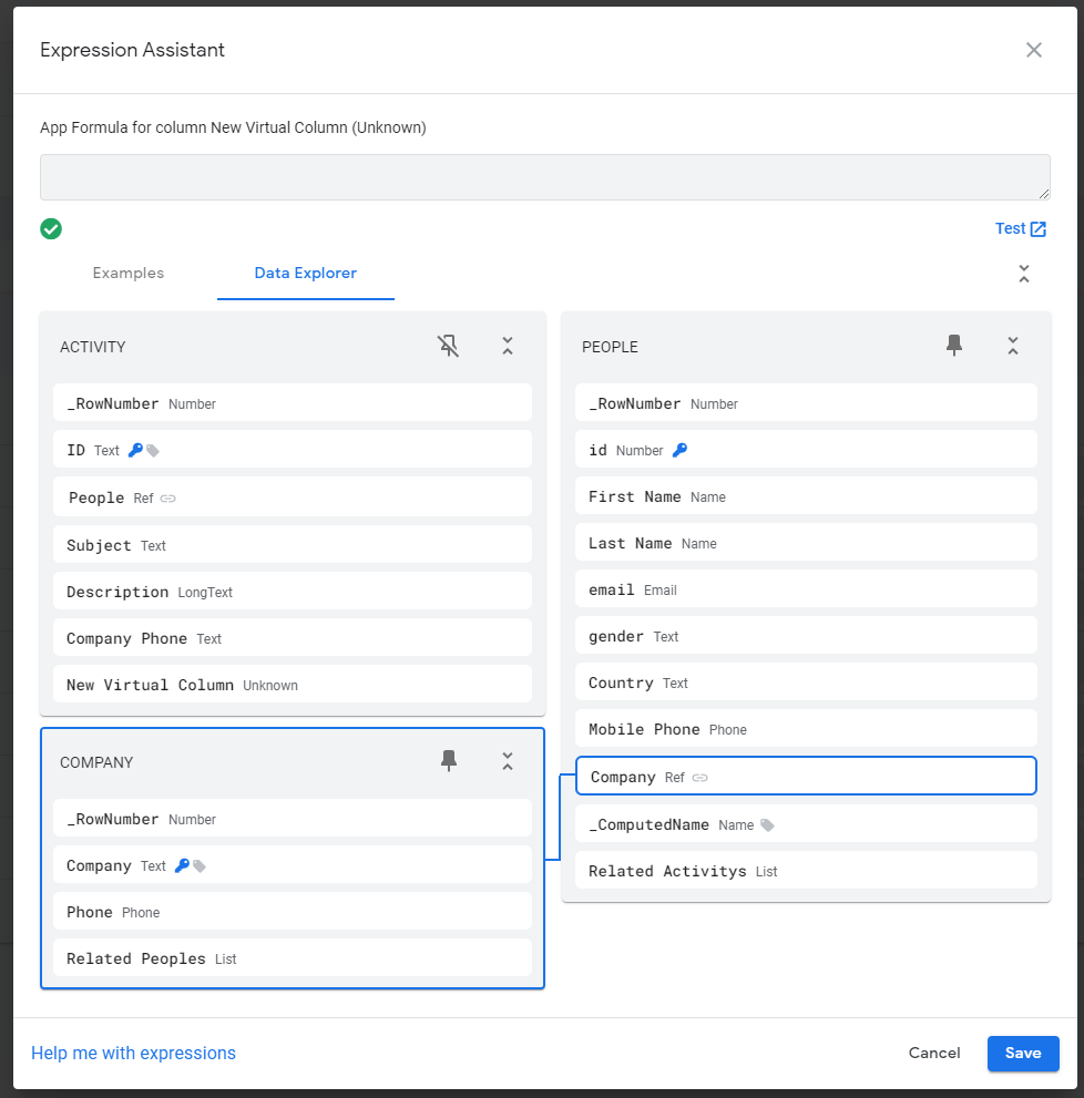

Today we are beginning to launch our new data schema explorer, which will let app creators explore their data tables while they are editing them.
Where can I find it?
The data explorer can be found as a tab next to the new examples tab while writing expressions in the expression assistant.
What can I do with it?
The data explorer is there to help you visualize your data as you’re working on your expressions, and make inserting columns into your expressions easier.
First, you can use it to see the names of all of your tables and their associated columns:
Hovering over any column will give you the ability to insert it into your expression where your cursor is in the text field:
Hovering over a ref column will show you what table that ref refers to. The ref can be clicked to persist the connecting line:
For those of you who want more space for writing your expressions, you can now also collapse the entire tab section, either by clicking on a tab that’s already open or by clicking on the expand/collapse icon in the top-right corner. This will be remembered, so the next time you visit this modal they will remain closed.
You can see me making use of all of these features in my app below:

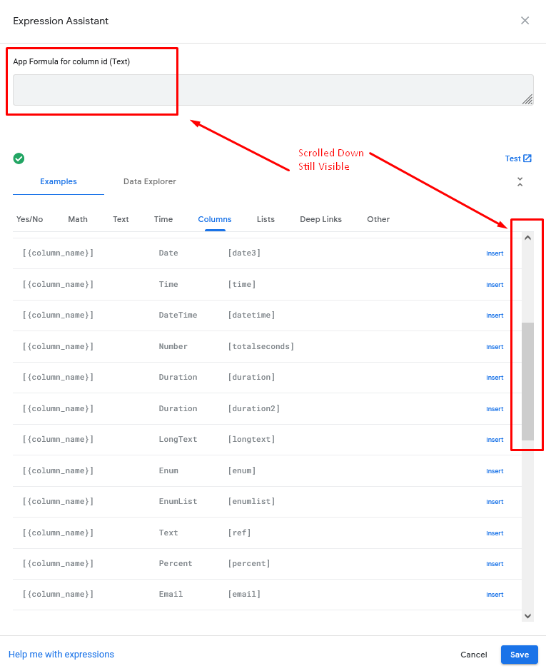

This part is a bit annoying though.
Old assistant examples:
new explorer pane:
And if you’re working on changes to the expression assistant, maybe you can move the Save button to the top as well?
Thanks for the feedback on that, I’ll try to make those have similar scrolling behaviour. As to the save button, one thing I did do is make the expression assistant a consistent size so the Save button shouldn’t jump around - you can also now just close the tabs so you won’t be waiting for something to load, and it’ll remember that state so if you’re an expert you can just always leave them collapsed. I think we’re still toying with larger changes to the Save behaviour on the Expression Assistant so I don’t want to necessarily change something right now until our UX team has done their research, but I also do think that a more standard location for the Save button should be towards the top.
Once we select REF type column, we are able to get the referenced table’s column to construct “De-ref” expression, which is super useful.
It would be find more useful we can construct the De-ref-list in the same way. Once we select the list type with base type - Ref, then we are able to pull the column to contruct [List][Referenced-column] so called “De-ref-list”
Hope this function could be under the scope of your further development.

Hi @benhare,
Can you please change the columns between tables that span multiple hierarchies so that they are populated with expressions connected by de-reference?
For example, in the following case, Company[Phone] is currently populated, but my expectation is [People].[Company].[Phone].
Example.
Create a VC called Company Phone in the Activity table with the following table structure

Nested de-references are trickier, and are less broadly used (especially by new users) but if it increases the value of this feature for more experienced users like you then I can give it a try.
Thanks @benhare
Considering the strength of AppSheet, which allows for the free use of tables and columns where relationships have not been established, the current specification of Data Explorer is understandable.
So, I thought it would be good to have a different mode that we can call Data column tracer.
Instead of displaying all the tables, this mode allows we to traverse the relevant tables from the table that started the Expression Assistant, and add the column beyond that as a de-reference.
I’m thinking of the following behavior.
I hope you find it helpful.
