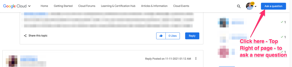

Hi
This seems like a totally new question, unrelated to the AesCrypto callout that was the original subject. Can you please ask a new question?
