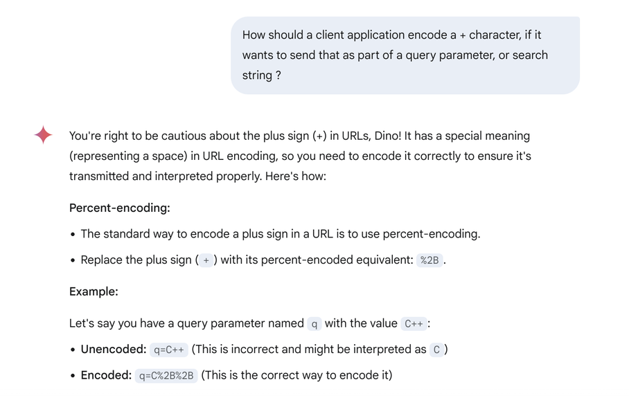

BTW, this is the advice Gemini has to offer on the subject:
Try to encode a URL before send it to the API to ensure that special characters within it are transmitted over the internet in a format that is safe and compliant with URL standards.
URL Encoding is a form of data encoding that is used in API calls to pass data within a query string. It is used to ensure valid URLs and data are passed between web applications and the server.
Original: https://api.xyz.com/example?test=123+abc
Encoded: https://api.xyz.com/example?test=123%2Babc
