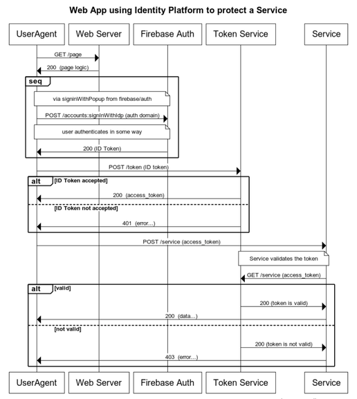

I think I am still not clear on what is calling what, or why. Maybe if you produced a sequence diagram that explained the actors and the messages they exchanged.
but I was wondering if it would be more efficient to proxy that login endpoint ...
You're weighing these alternative designs in the pursuit of efficiency... For myself, I don't think "efficiency of login" is going to be a critical measure of success for most systems. How often will that happen, and how many concurrent transactions will there be? I suppose it will be "not very often" and "not very many" in contrast to the OTHER transactions, which are many and often. Though I could be wrong. If login happens rarely, then it's not worth bending your architecture into unusual shapes to accommodate the efficiency. But as I said, despite your verbal explanations, I don't understand what is calling what, and how, so I can't offer an opinion on whether one option is better than the other.
In my experience, if we are talking about a web app
  • a user visits a page that provides a service, but which requires login
  • the page logic calls signinWithPopup from firebase/auth
  • There is a signin flow, that points to firebase logic.  Firebase Auth (aka Identity Platform) handles this flow
  • After completion, the original page receives an ID token of the authenticated user, or ... nothing if the user declined to signin.
  • The page then goes about its business. One option is: It can send that ID token into a service that grants an access token, and then request service using that access token.
like this:
Or, possibly, there is a separate service involved that grants access tokens.  Maybe it looks like this:
