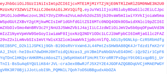

Thanks @dchiesa1 . We are able to decrypt the response & response has three sections separated by period. Is there a way to base 64 decode the response by using the period as delimited ? we see 1. JOSE Header 2. JSON Payload & 3. JWS Signature in the response so how do we handle the base 64 decode, verify signature only for the JWS signature & send the json payload back to the client app?
Well it sounds like the response payload (decrypted) is ... a JWS or JWT.  Probably JWT.
You can use DecodeJWT to split and then base64-decode the header and payload.  (Or DecodeJWS if it is a JWS)  But neither of those policies verifies a signature , which you should do.
So I would suggest that you try VerifyJWT on the 3-part dot-separated thing.  And somewhere in your environment, you need to have the information about  how to get the public key to verify the signature. I don't know how to solve that, but maybe you do.

thank you Dino @dchiesa1 . once I use Decode JWT policy , I am able to see the plain text response payload. It all works now . you made my day.
ha, I'm glad you got it to work!
Please note: DecodeJWT does not verify the signature!   You should not rely on data that is revealed by DecodeJWT, unless and until you verify the signature, with VerifyJWT.  If you use VerifyJWT, then you will also get the payload in context variables, in the same way you get the data with DecodeJWT.   But VerifyJWT does the extra step of verifying the signature on that data, which assures you that it has not been modified since the signer signed it.  Ergo, after VerifyJWT, the data is trustworthy.
