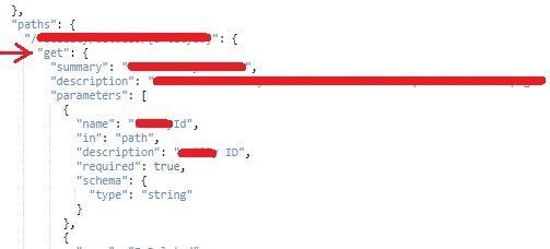

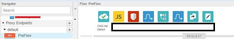

Bypass the OAS validation and trigger the MethodNotAllowed
When I changed the method from "GET" to "POST," I got "400 Bad Request," which is not good at all. I have a flow that will trigger if the user changes the method. I need to bypass the OAS validation so that the "method not allowed" error message appears in my response. I put the OAS validation policy in the Proxy Endpoint/PreFlow.

I am a little perplexed by your question.
You have an OAS spec that disallows POST.
You have an OASValidation policy , using that spec, in your proxy.
When the client sends in a POST request, the proxy returns 400 Bad Request.
That seems like the right thing.  You said "That is not good at all."  But that is the meaning of 400 - it is a way for the server to tell  the client that the  request sent by the client was invalid.
I guess you want more elaborate information in the error message? Is that right?
Yes thats correct

Instead of bypassing the OAS validation, you could add your RF policy before the OAS Validation with a condition based on the request.verb
