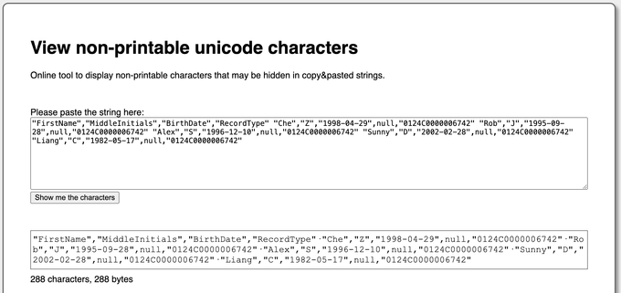

How are you determining that the CRLF is being translated to a "dot" ? I understand you are using that website
(htt​​ps://ww​w.soscisurvey.de). But how do you get the data into that website? Presumably you paste it? And you copied the content (ctrl-C) from where?

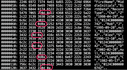

When I tried invoking an API that does JSON-to-CSV conversion, via curl from my terminal, I get what appears to be correctly formatted text:
That looks like newlines to me. When I use the -o option with curl, which tells curl to emit the output into a file, then open the file in a hex editor, I can see the CRLF sequences.
When I open a debugsession (trace), and copy the string out of the debug window, then paste it into soscisurvey.de , I see dots!
The dots are just how THAT WEBSITE represents an actual CRLF sequence. That's not Apigee inserting dots. It's the website you chose to use.
So, please double-check your assumptions. Maybe what you think is happening, is not really happening.

Hi @chrismca73  ,
Thanks for the response, but still facing the error regarding CRLF.
Each line of csv file should have this CRLF/LF in it. We can see if these character is present of not using either by View non-printable unicode characters (soscisurvey.de) or we can see it inside notepad++.
So these CRLF characters are being converted to period (.)
The requirement was to add double qoutes around all the not null values.

Response I am getting(check inside the above mentioned site) :
"Name","DW_MiddleInitial__c","DW_BirthDate__c","RecordTypeId"."batch",null,"update",null,"0124C0000006742"."batch",null,"update",null,"0124C0000006742"."batch",null,"update",null,"0124C0000006742"
