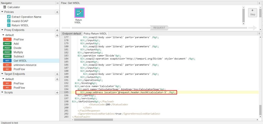

Hi @Ajay Tiwari, now I understand the question, so you have used a Soap-Pass through Proxy and you are making a GET call to get the WSDL from a Raise Fault policy in Proxy
As seen in the image it is coming from a context variable, which is just taking the request host value.
One way is to manually hardcode http://before @request.header.host# variable
location='http://@request.header.host#/calculator-5'

I have given http://www.dneonline.com/calculator.asmx?WSDL and created proxy whenever I am opening proxy URL in browser at the address location this has to be
<port name="CalculatorSoap" binding="tns:CalculatorSoap"> <soap:address location="http://ajytwi-eval-test.apigee.net/calculator"/>
</port>
Http is missing at the soap address location.
