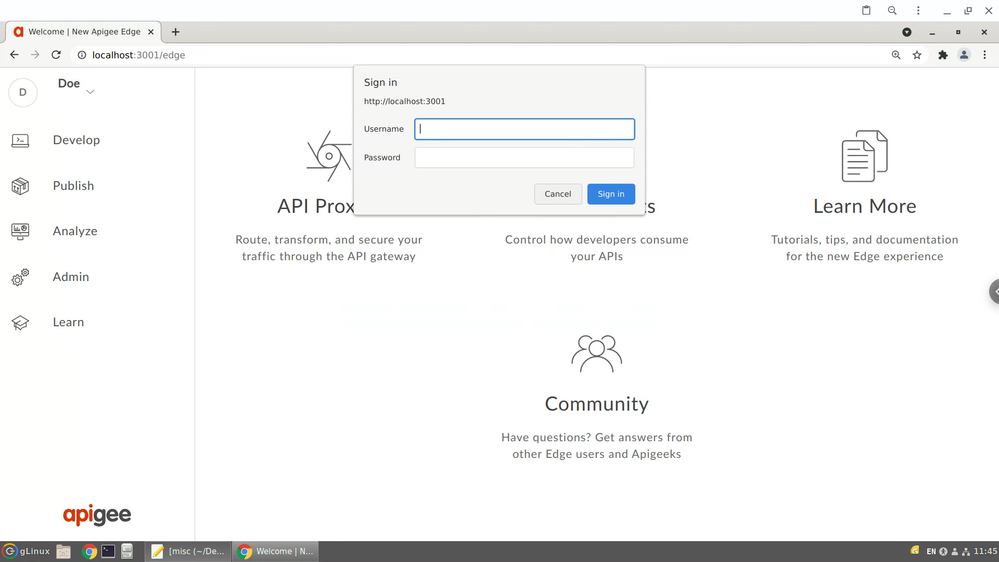

Error while installing Edge UI for OPDK - ApigeeSsoJwtVerifier is not initialized
I am trying to install new Edge UI for OPDK, after complete installation when i try to access the UI at localhost:3001, I get a Pop-up asking username and password and error is generated in management server log file
2021-04-30 11:34:25,396 org: env: target: contextId: action: qtp1878992188-52 ERROR SERVICES.SECURITY - JwtAccessController.verifyWithAppropriateJwtVerifier() : ApigeeSsoJwtVerifier is not initialized, verification not possible 2021-04-30 11:34:25,397 org: env: target: contextId: action: qtp1878992188-52 ERROR REST - Authorizer.beforeInvocation() : Authorizer.beforeInvocation: Detected an authentication failure.
2021-04-30 11:34:25,398 org: env: target: contextId: action: qtp1878992188-52 ERROR REST - CustomJAXRSInvoker.performInvocation() : CustomJAXRSInvoker.performInvocation : Method com.apigee.security.usermanagement.UserManager.getRolesForUser threw an exception.
2021-04-30 11:34:25,398 org: env: target: contextId: action: qtp1878992188-52 ERROR REST - ExceptionMapper.toResponse() : Error occurred : Authentication failed for user : {0}
