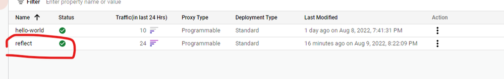

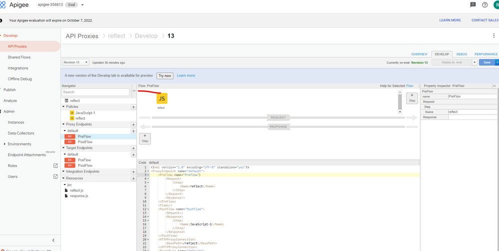

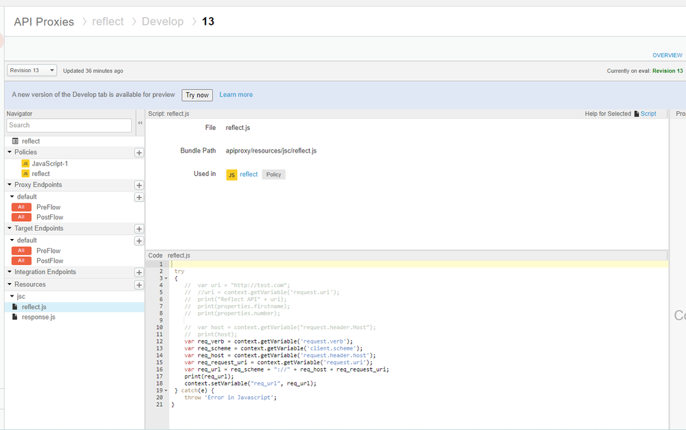

You'll need to be more specific about what you mean by "stops working". What specific buttons do you click and what do you see? Screenshots would help. a recorded screencast showing exactly what you are doing would be ideal.
Proxy home.pngreflect debug result .pngreflect debug.pngreflect policy xml.pngreflect postflow jsfile.pngreflect postflow.pngreflect preflow jsfile.pngreflect preflow.png
