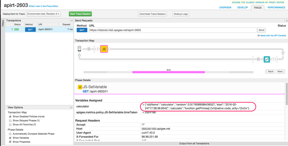

That won't work properly if you want to see the content of the properties of type function . JSON.stringify(), by definition, omits properties of type function from the output. To rectify this, you'd need to use a replacer function, like this:
function replacer (key, val) {
  return (typeof val === 'function') ? '' + val : val;
var s = JSON.stringify(calculator, replacer);
context.setVariable("calculator", s);
And the result is like so:
But even there, you don't get to see the source of the function. On the positive side, you do get to see that it IS a function.
