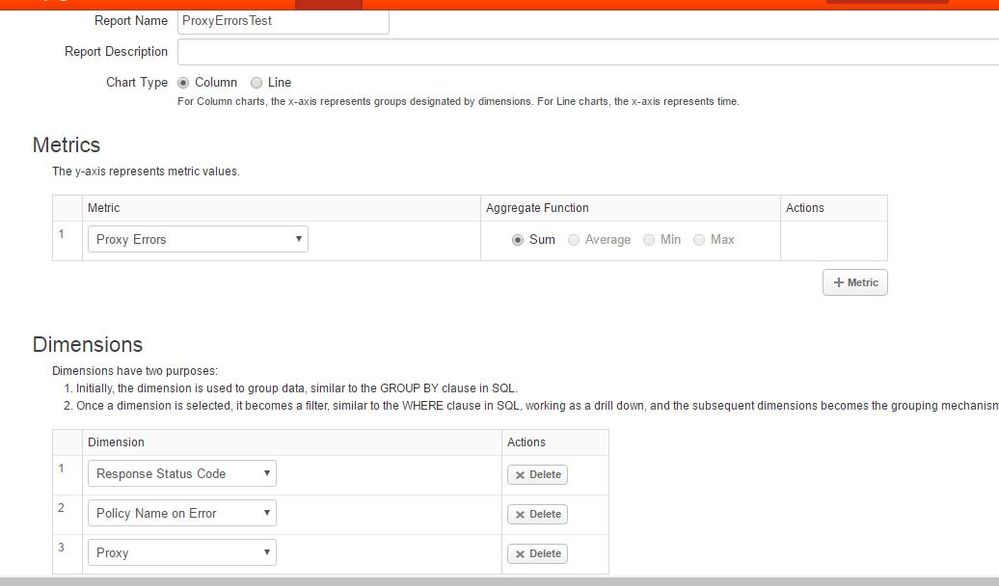

I created one custom report for all the errors encountered for the proxy and the policy is generating the error.
My report matrix and dimensions are as follows:

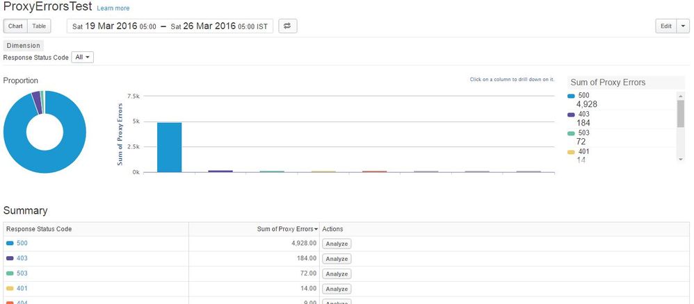

When selected a range I am getting report as follows:
Now for error code 500 I want to check what all policy caused 500 error, which I am getting indeed.
But the thing is there is one more value with "Policy Name on Error" = "(not set)" which is coming probably because the error is not from any policy, rather it is from the target.
Now how can I remove this from the report or is there any way to set some other value (any default value)?
