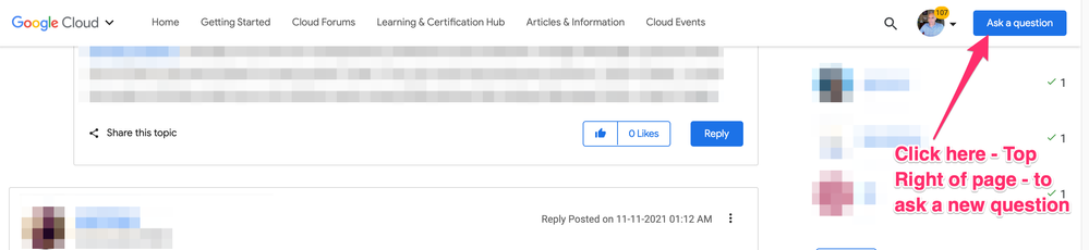

This is an interesting question and I would like you to ask it as a new question, s it does not get buried in this one-year old discussion. Can you do that?
