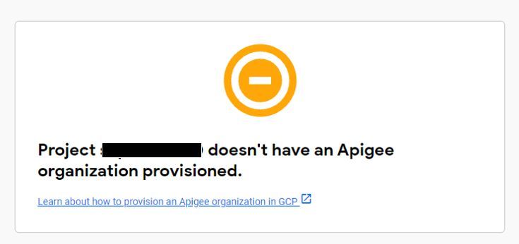

I want to use Apigee again.
I deleted the apigee organization and tried to create the project again, but the following screen appears and I cannot create it.
Is there anything I can do?
0 4 532
From the message, Your project doesn't have an Apigee org provisioned.
Did you click the link to try to (re-)provision one? And what happened?
If you did that and it didn't work, then, You may need to create a new project. (start over)
