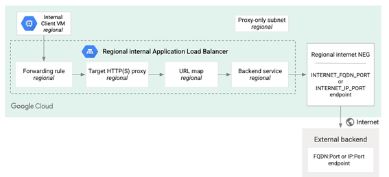

We ended up deciding that a Regional load balancer with an External backend (internet NEG) should be the most feasible option to establish connectivity to the Google APIs configured under the private.googleapis.com VIP. In particular the customer wanted to access the Maps API. The Maps API will be the API service that we want to establish connectivity to for this article.
The end architecture that this article addresses is below.

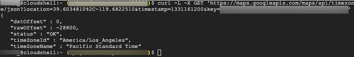

Test #1. Test connectivity to the Timezone API via a curl call directly to the maps.googleapis.com endpoint. This curl is not utilizing a configured Apigee proxy and should work due to the fact that we set up a service perimeter via VPC-SC on the project (which by default the connectivity to the Google APIs in the restricted IP range 199.36.153.4/30 is established). At this point we just want to confirm that the service perimeter is working as intended.
curl -L -X GET 'https://maps.googleapis.com/maps/api/timezone/json?location=39.6034810%2C-119.6822510&timestamp=1331161200&key=[replacewithyourapikey]'
So with this curl call we can see that it’s successfully connecting to the Timezone API while the service perimeter is enabled.

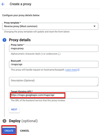

Test #2. Now let’s create an Apigee Proxy and deploy it. For the proxy configuration we are going to have the target endpoint configured in the same aspect as the curl command we used above but we will be utilizing the Apigee hostname to call the proxy in the environment the proxy is mapped to. The expectation is that the curl call through the proxy should fail

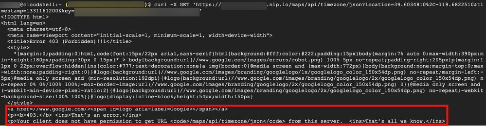

Now try the curl call with the Apigee hostname and ensure that you pass the API key you created above.
curl -X GET 'https://[replacewithyourApigee Hostname]/maps/api/timezone/json?location=39.6034810%2C-119.6822510&timestamp=1331161200&key=[replacewithyourapikey]'
With this we can see we're getting a 403 Forbidden. Optionally, you can also run a trace session in tandem to look at the end to end details of the API calls.

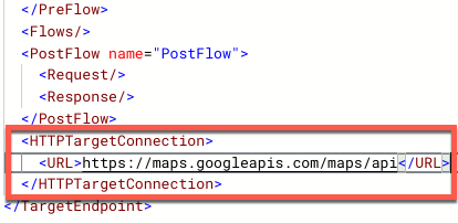

Test #3. For this test just simply change the XML in the target endpoint postflow to point to the regional LB IP that was created above. Also, feel free to remove the SSLInfo block if applicable.

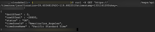

Now let’s test this proxy by running the curl again in Cloud Shell or a Terminal connected to your GCP project:
Success! We are now able to connect to the Timezone API, a part of the Maps API that resides under the private.googleapis.com VIP while we have VPC-SC enabled on our Apigee X deployment.
