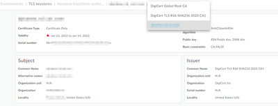

In this case, the cert is issued by "DigiCert", which I'd consider meets the definition of a third-party, so the complete chain was uploaded. I need to obfuscate this picture for security reasons, but this should give the picture that its all loaded within the same 'alias' of the trustStore.
Pretend that's the certificate for 'host.example.com'. It's stored in the trustStore that is referenced by the targetServer's "trustStore" property.  Here is how the targetServer object is defined:

From the screenshot it appears the final certificate in the chain (a.k.a. client certificate) is expired (Jan 14 2023). Thats the certificate Apigee sends to the server. The server then validates it is genuine (or not). Of course before the client certificate is sent, Apigee does validate the server certificate is valid as well. It appears, from the information you provided, the server is not validating the expiration of the client certificate sent by Apigee, and perhaps other important stuff too.

@mark_hammelman Seems like you have CA (DigiCert Root and Intermediate) and Leaf (Server) certificate added in your trust-store, since CA certs already in the trust-store, Apigee might use the CA certs to trust the TLS connection from client perspective as it usually has longer validity.
May be you could try only adding a Leaf (server) certificate which is expired in the trust-store and see Apigee is trusting the TLS connection. I hope not.

The "root" and "intermediate" certs are not loaded as different 'aliases' in the trustStore. When I created the alias for this "host.example.com", I uploaded one file that contains the entire chain.
I can upload only the "leaf" certificate to test it, but this seems to contradict the documentation I mentioned in the first post "If the server certificate is signed by a third party, then you will need to upload the complete cert chain, including the root CA cert, to the truststore."
