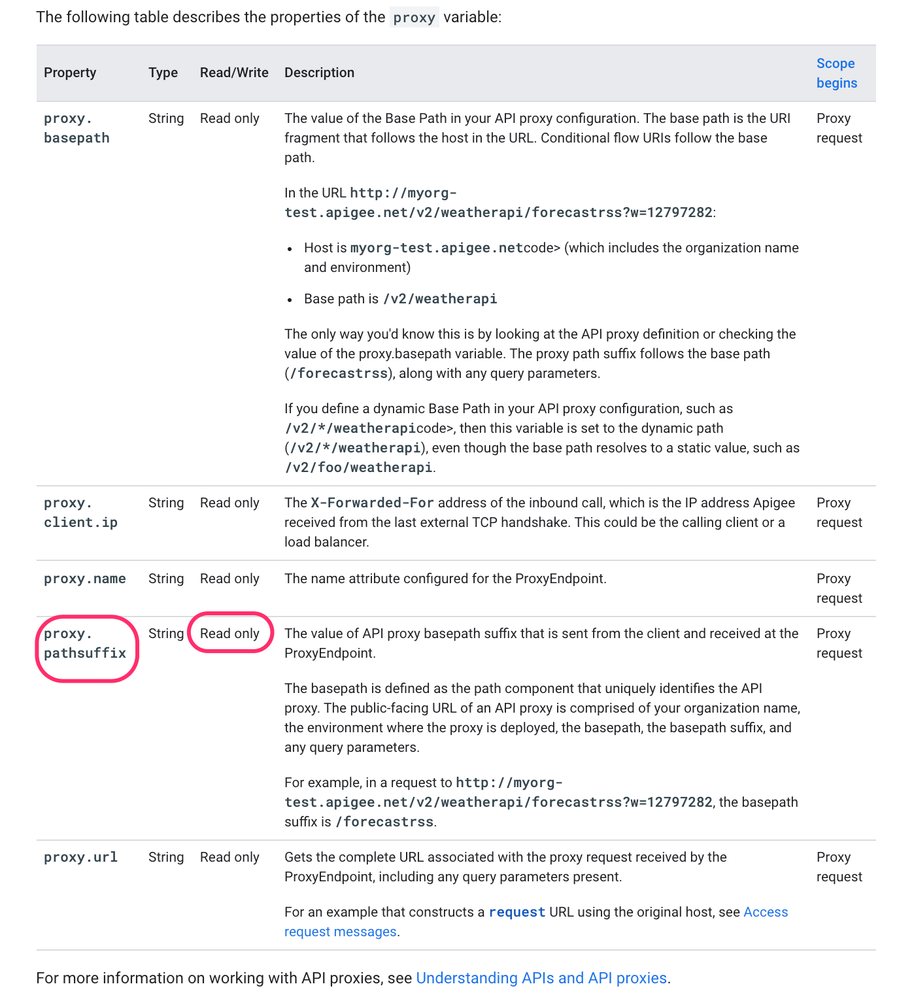

You cannot update proxy.pathsuffix. It is a read-only variable.
If you look in the Trace, you can see a small indication that your attempt to update proxy.pathsuffix has failed.  The equals sign with a strike through it.
