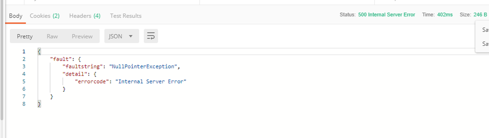

Null Pointer Exception when creating Tokens with Implicit Grant Type
I'm receiving the Following error when trying to create a token the Implicit Grant type
Error 500 : Internal Server Error
Time: 357ms
    "fault": {
        "faultstring": "NullPointerException",
        "detail": {
            "errorcode": "Internal Server Error"

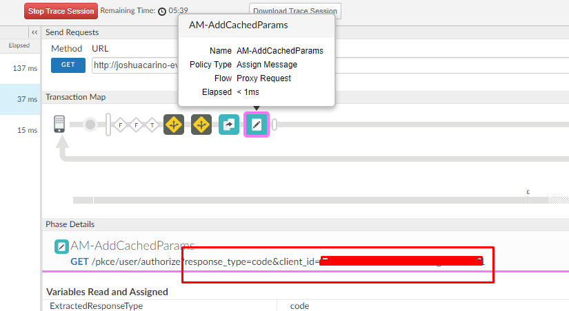

Hi @Dino-at-Google, there seems to be a problem with Apigee Edge. As everything like this redirect_uri, and now client_id is not being detected by Edge even though though I could very well see in the trace that it is being appended in the flow.
