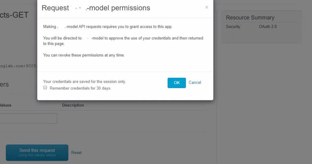

If I go to the portal in any method of my model on the portal and press the OAuth2 button, I see a form in which I can not enter a consumer ID and secret.
After clicking OK, I get an error:
"Unable to proceed because of missing OAuth configuration."
What I did not consider when setting up OAuth2?

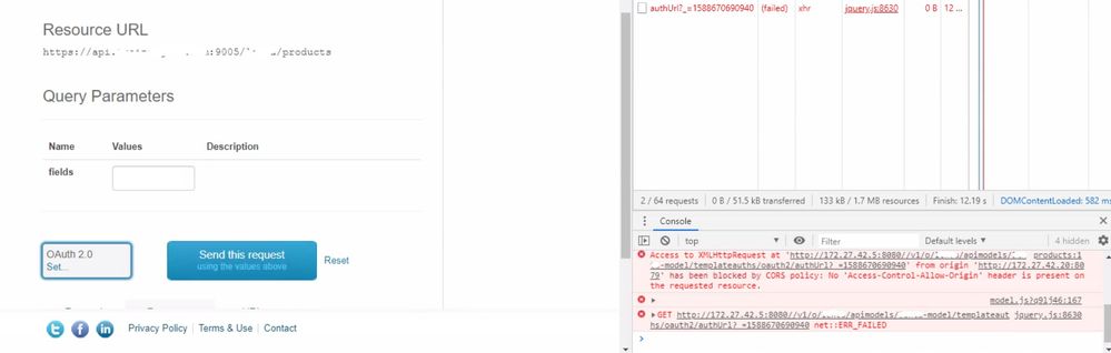

When I click on OAuth2 button I geе the following errors:
I added CORS to my proxy, but the error did not disappear.
What resource should be specified in the authorization URL field in the security scheme? Thank you.

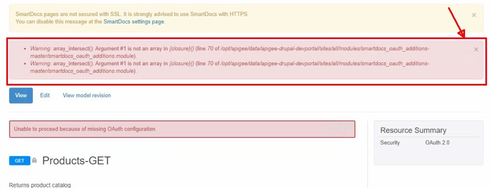

I missed one error. I get this error first:
GET http://172.27.42.20:8079/sites/all/modules/smartdocs_oauth_additions-master/smartdocs_oauth_addition... net::ERR_ABORTED 403 (Forbidden)
The module was loaded and enabled without errors. What rights may be missing for smartdocs_oauth_additions?

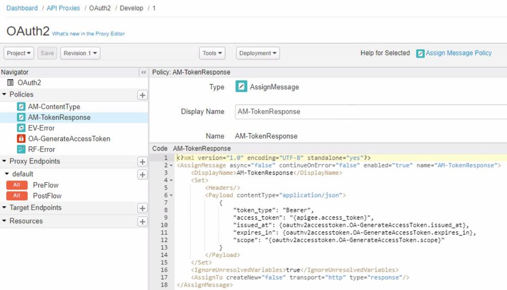

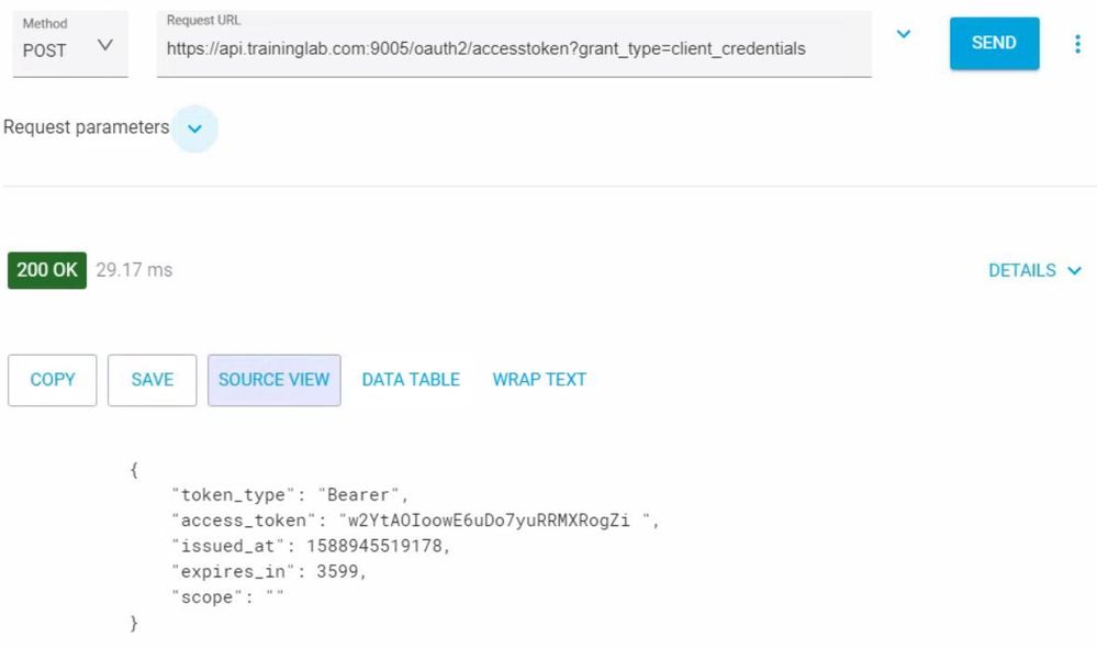

Good day, Kurt. It seems to be all right with this. I redefine the response when generating the token using the Assign Message Policy.
This is the response from my Oauth2 endpoint.
And this is a screenshot of my policy overriding the response:

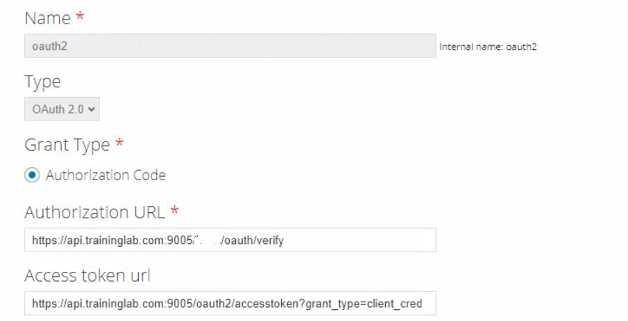

I'm not sure if my security scheme is configured correctly for the model:
What should I set as an Authorization URL?
As I understand it, here I need to write the path to the flow, which verifying the token.

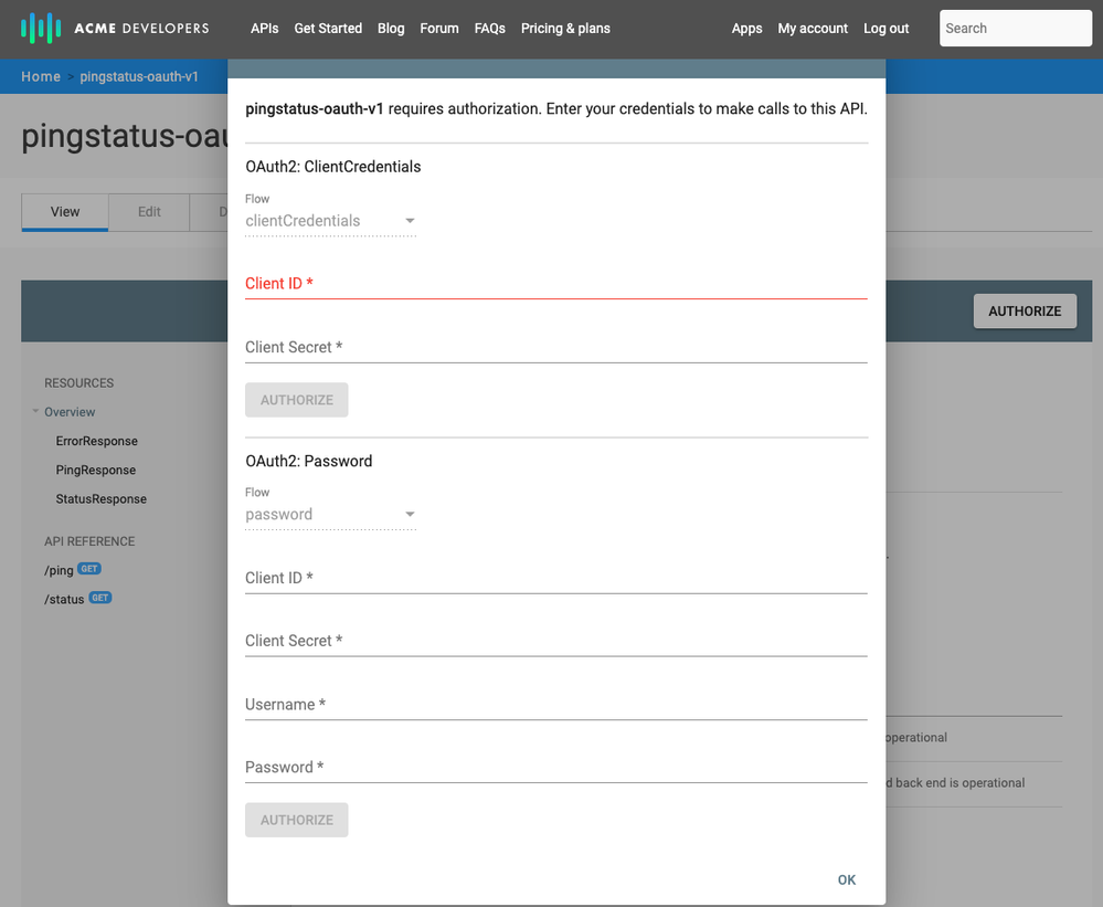

Looks like you are specifying Authorization Code grant type, not Client Credentials in your Open API Spec. Here's what I use for OAS 3.0.
security:
  - ClientCredentials: []
  - Password: []
components:
  securitySchemes:
    ClientCredentials:
      type: oauth2
      flows:
        clientCredentials:
          tokenUrl: https://ORG-test.apigee.net/oauth/v1/token
          scopes: {}
    Password:
      type: oauth2
      flows:
        password:
          scopes: {}
Here's a screen shot from my Drupal 8 portal
Hope that helps.
On the portal (I have drupal 7.69 with Private Cloud 4.19.06) it is possible to import only swagger version 1.2 (I originally had the openapi 3.0.1 yaml file). Only after converting it to wadl I was able to upload the API description on the portal.
No other grant grant can be selected here. Advised in many topics to use a special module on Github. I uploaded it to Smartocs. Yes, now I see this phrase in the settings of the security scheme:
But as you can see from the screenshot, you cannot choose another grant type. Plus the warnings from this module that I mentioned in comment above.

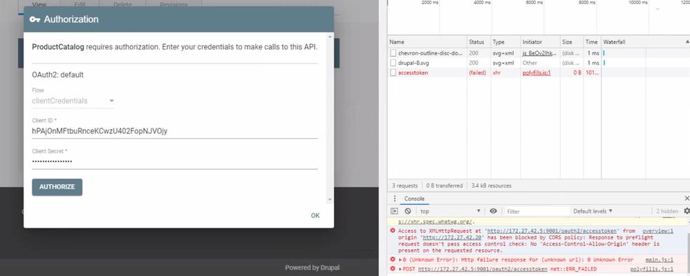

Hello, Chris! Yes, I was able to upload spec with OAuth client credentials. But I have problems with performing requests from the portal. As in the portal version 7.69 there were errors associated with СORS:
When I set a https URL in my spec, I get an error ERR_TUNNEL_CONNECTION_FAILED.

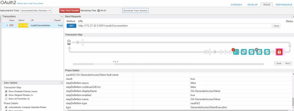

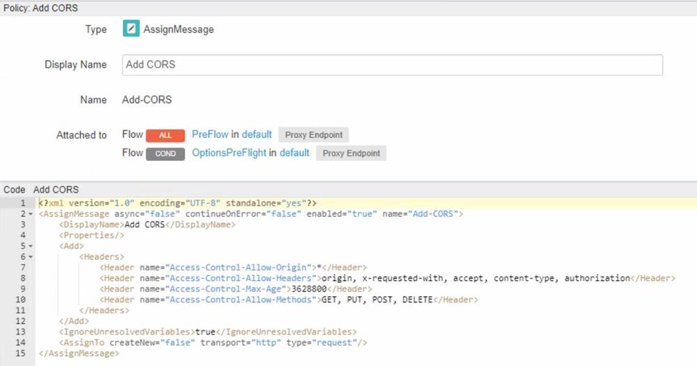

By running the track on my OAuth2 proxy and trying to authorize on the portal, I see that the error occurs on the options request:
My API proxy, which generates a token, contains an Add Cors policy on preflow.
Add Cors Policy definition:
I found an article that describes how to configure cors.config in ../devportal/web/sites/default/services.yml. But not sure if this will help.

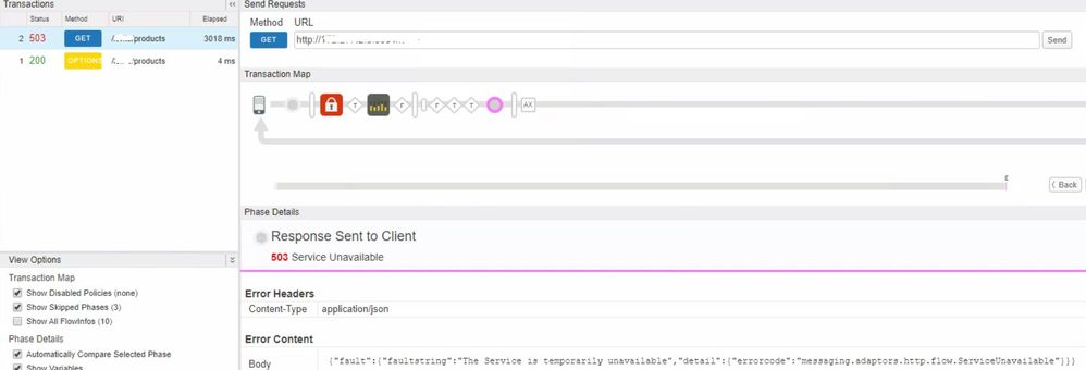

I became interested in this case: my target service was stopped. I received a token on the portal, clicked on the Execute button. On the portal I see:
Unknown status
{ "isTrusted": true }
In the page code, I see a СORS error: "No 'Access-Control-Allow-Origin' header is present on the requested resource."
In the flow trace, I see the 503 error:
СORS policy is in all responses. Why these headers are not present in the response?How can I catch such error (503) in order to avoid the occurrence of CORS error on the client?
@home home When an API proxy encounters an error, regardless of how it occurs, it exits the normal flow pipeline, enters an error state, and returns an error message to the client app. To ensure that the error gets relayed to the portal, you would want to add a DefaultFaultRule- https://docs.apigee.com/api-platform/fundamentals/fault-handling#creatingfaultrules
Thanks, it's work.

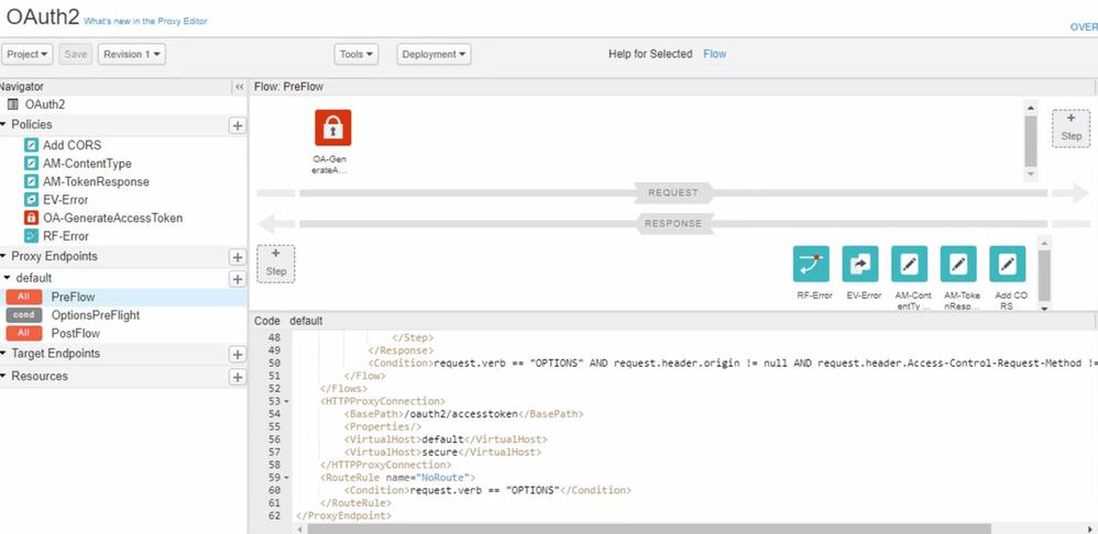

Hello! I had an error with CORS when calling a proxy (/oauth2/accesstoken) generating a token. Having looked at it carefully and analyzing the error with the OPTIONS request, I realized that I need to make a separate flow with OAuth2 policy to generate a token with the necessary conditions: (proxy.pathsuffix MatchesPath "/accesstoken") and (request.verb = "POST").
I realized that preflow with this policy is not suitable, because of it OPTIONS request did not pass.

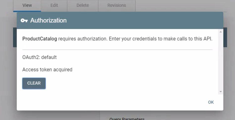

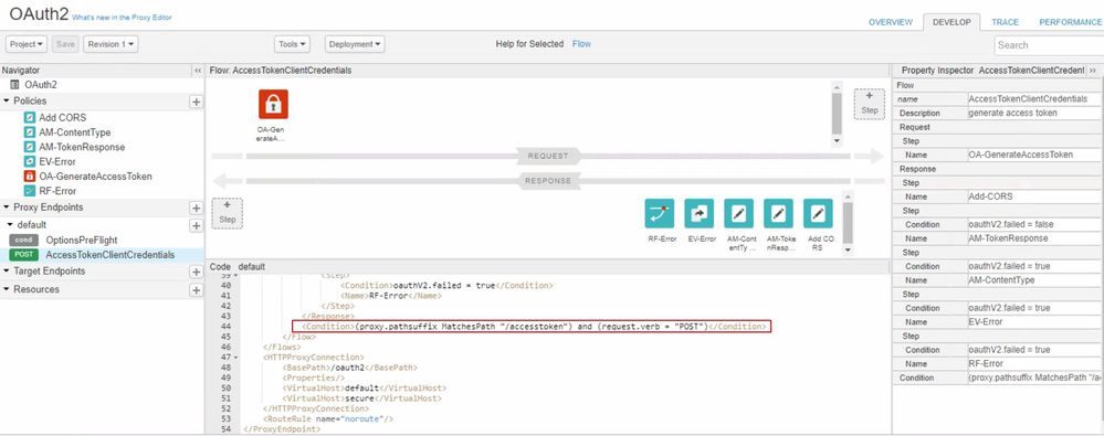

I changed proxy basepath and added another flow "AccessTokenClientCredentials". After that, I was able to log in and get a token on the portal:
That is, for normal work with CORS, a flow that processes the preflight request OPTIONS is needed (Add CORS policy on the response):
        <Flow name="OptionsPreFlight">
            <Description/>
            <Request/>
            <Response>
                <Step>
                    <Name>Add-CORS</Name>
                </Step>
            </Response>
            <Condition>request.verb == "OPTIONS"</Condition>
        </Flow>
Since my proxy /oauth2/accesstoken does not have an endpoint, I don’t need any special route here. Just specify:
<RouteRule name="noroute"/>
Portal token generation works!
