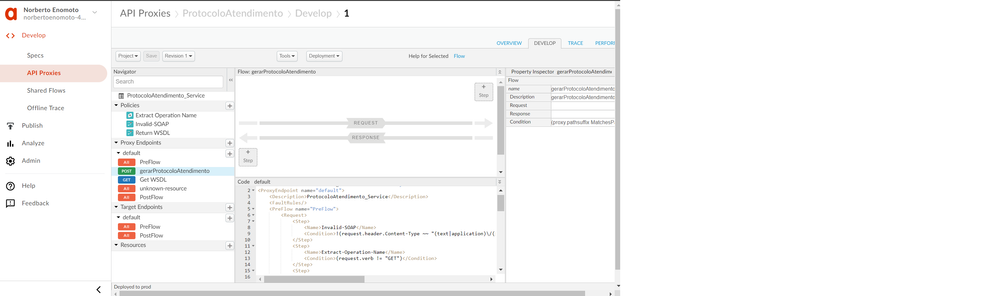

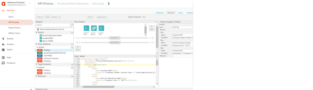

I really don´t know what´s wrong. Attached the print screen with the PreFlow and the Post method. At the Post Method, there is nothing in the Request and Respose. Do I need to implement the Request and Response with some Policies? The only thing that is working, it is the Get WSDL. The backend soap service is up and running.
