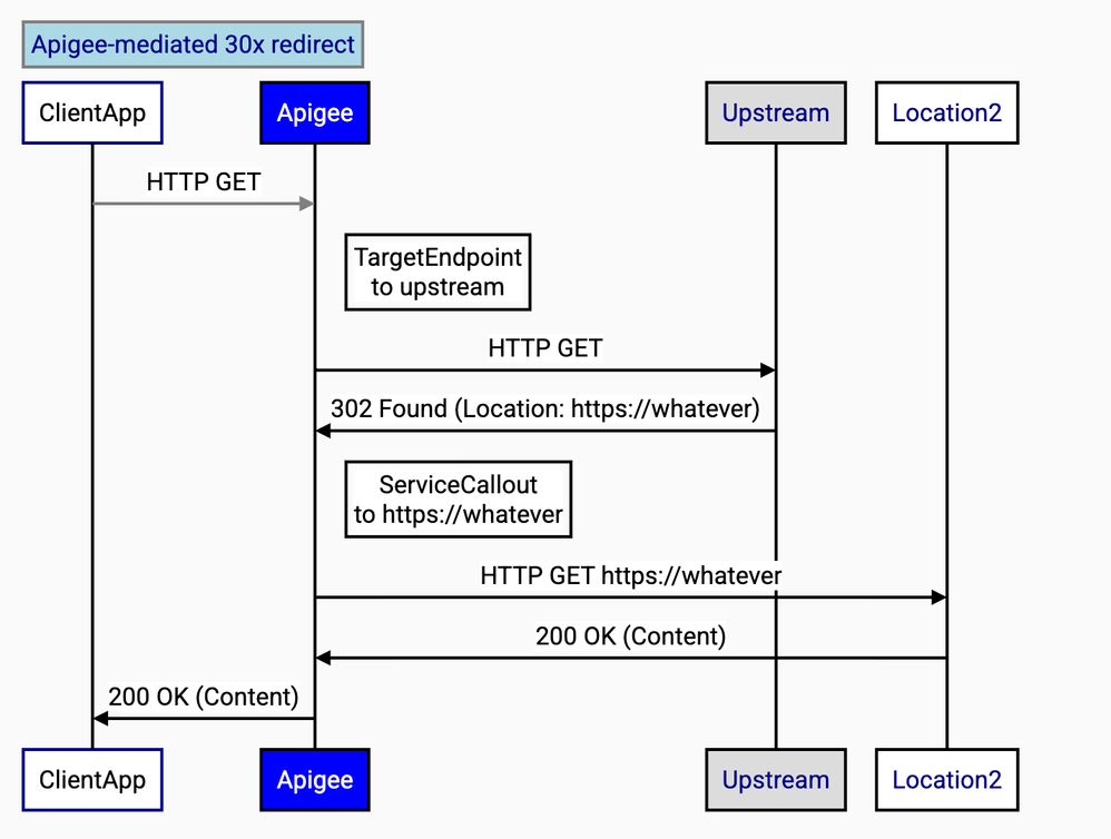

ok thanks for that explanation. I understand that in your API proxy, when the proxy receives a 303 status code, you are executing an AssignMessage policy in the Target Response PostFlow. In that assignMessage policy you set the statuscode and assign a few headers. Because the AssignTo element is blank, this AssignMessage will affect the "message" variable. Because the policy is attached to in the Target Response PostFlow, "message" will be the response message. So with this policy you are overwriting some things in the response message.
After that policy executes, I expect that Apigee will transmit the response message back to the originating client. That will happen, unless you have something in the ProxyEndpoint logic to modify the response message further. I guess this explains what you are observing. According to my understanding, Apigee and your API proxy are working as documented.
I think you are expecting that by executing an AssignMessage policy, the Apigee API Proxy will follow the redirect implicitly. That is not the case. Executing AssignMessage does not cause an outbound request to be sent. There is no configuration of the AssignMessage policy that you can apply that will cause AssignMessage to "follow a redirect." Also, there is no setting on the Apigee TargetEndpoint that is analogous to the -L option on the curl command. If you would like Apigee to invoke the URL specified in the Location header in the target response, you need to configure specific, explicit logic to do that. That logic might be a ServiceCallout or a JavaScript policy which uses the httpClient. Either of those things will send out an additional HTTP request. If you do this, then you'll want to wrap the policy in a Condition such that the ServiceCallout or JavaScript gets called only in the case that there is a Location header in the response. Possibly you may wish to check for 302, 303, 307 etc. as well. AssignMessage will not cause Apigee to invoke an external endpoint. all it does is assign to the internal variable that holds the message content.
If you use ServiceCallout then the configuration should be something like this:

Hi @dchiesa1 ,
Thank you, for the detailed answer!
I have already implemented ServiceCallout policy as a work around solution.
Because of this the flow is  Client > ASGW > Target 1 > ASGW(ServiceCallout) > Target2. This is increasing the number of network hops resulting in increase of response time.
I was just trying to follow the solution provide in this  page. When I am using the AssignMessage policy as mentioned above. In the trace, I can see response received from target 1 is 303 and location header. After AssignMessage policy is executed the Status code is 200 with no response body. So the client is receiving 200 with no response body.
ok I understand you are concerned about network hops. I don't understand the flow you're showing.  Normally a redirect is like this:
And I think what you want is the client app (or maybe browser) to invoke an Apigee endpoint, which invokes some upstream system, which returns 30x, and then you want Apigee to invoke the 2nd location. like so:
That is what I showed you how to do in my prior reply.  You need to use ServiceCallout within Apigee to follow the redirect.  And then after ServiceCallout, copy the response from SC to the response Apigee will send to the client.
I understand you are concerned about network hops, but any 30x response code will require an additional request, from SOME ACTOR.  It can be either the originating app, or it can be Apigee, but to follow a redirect there must be an additional request.
