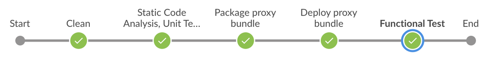

Hi @Sai Saran Vaidyanathan
I am trying to use the Jenkins deployment which you have suggested and going through the jenkins file to understand each step.
  1. I am not getting what this step :
stage('Package proxy bundle') {
steps {
sh "mvn -ntp apigee-enterprise:configure -P${env.APIGEE_PROFILE} - Ddeployment.suffix=${env.APIGEE_PREFIX}"
would do wrt API Proxy?
2.And what is overall packaging do? When i used the below maven command -
mvn package "pom.xml" -Dusername -Ptest -Dpassword
created a copy of the APIProxy bundle along with the Zip with version.
3. In CICD we need not have a version control or save the package in Git?
4. If we use the Apigee management api's also we cannot use the Zip file for deploying the bundles - correct me if I am wrong?
So overall I want to understand the importance of the Packaging stage to be included in the CICD Pipeline. If you can just give me some hints on that it would be great help.
Sorry my questions might be very basic I have started working on APIGEE recently please help me out
Thanks,
Naveen

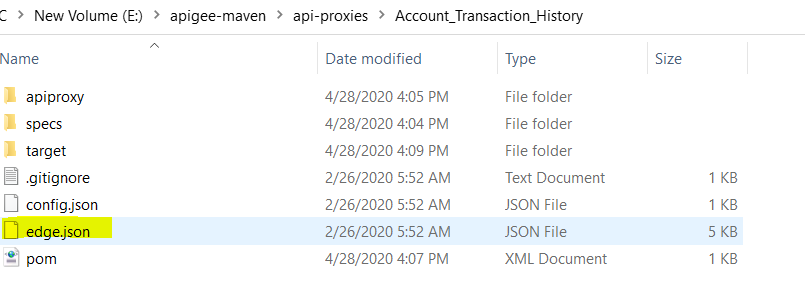

Hi @Nagashree B,
Since we use the Maven for packaging and once the packaging is done it wont be having the Configurations like KVM, Cache Target servers etc..they will not be a part of the Zip file.
How can we manage the configurations? if we are using the Repositories later for deploying?
Attached the screen shot for the folder structure.
Thanks,
Naveen
Please check my repo, its got the config as well. Configurations are not part of the bundle (zip), so you need to run it before. You can control what to execute when in the pom.xml using the phases. You will be using the Apigee Maven Config plugin for pushing these configurations. You can check samples there as well
@Naveen Chalageri
+1 to all that @Nagashree B mentioned
1) I have defined that as a separate step as its part of packaging. In that step, the plugin is taking the code from the repo and creating the bundle (zip). This is usually done in most of the build. They use this as a separate stage in their build. This can also be used to push to the artifactory system to deploy to higher environments. Pushing it to artifactory will be the last step after testing is complete and successful.
2) Maven has a lifecycle when you execute the phase. Please see this link. It executes in that top-down order. So if you have other build plugins in the pom with those phase enabled, they all get executed in that order. So if I run mvn package, it also runs the unit test. So I wont be able to capture it as a separate stage in my pipeline. Hence I split it by calling the individual task for each stage so that the pipeline is cleaner to visualize. See the screenshot
3) As @Nagashree B mentioned, it depends. In my example, I have not used any artifactory system but you could. I am relying completely on my source control and branches to maintain that. In my example you will see that when it deploys, it automatically adds the Git branch, commit Id, deployed by info to the Description of the proxy. So you know exactly the source from where this was pushed. See screenshot
4) No you can. In fact the Maven plugin after creating the zip uses the Management API only to push it to Apigee. I would just recommend stick to one tool if it does all you need. Don't complicate using many tools (like using Maven for packaging and apigeetool for deploy). Although you can, I am recommending to one tool for ease of use and maintainability.
To summarize - packaging is an important portion of your CI/CD process. Like any other language. In java, you create a jar, war, ear and thats always a separate task. So just using the same approach here. Hope this helps !
