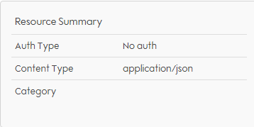

I have swagger 2.0 yaml defined for set of APIs where securityDefinition is set for apikey as queryparams. When I create Smardocs model using this swagger, I have following issues:
1. On the individual API page, in Resource Summary section, I see ‘Auth Type’ defined as ‘No auth’. Won’t Smartdocs pick the ‘securityDefinitions’ from swagger? Do we need to explicitly set the custom token authentication settings in Smartdocs ?

@Neha Pamnani Not sure if I am missing something... But this is what i did,
1 . Created a smart-doc model
2. Added a new API revision by importing Swagger JSON
3. Modified the revision by setting the 'Auth Settings' with 'Custom Token' section with API Key
4. Edit API 'Method' and Set the authentication to CUSTOM --> Update Method
But still i see that the 'Resource Summary' section displays 'No Auth':
Here is the build info of the portal :
Version: Developer Services 15.01.30.00

Upgraded the Developer Portal to 15.12.11.01, now it seems to be working!!
Thanks @Neha Pamnani
