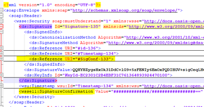

I am currently working on a service that requires sending the WS Security signature, so I used your contribution Java Callout for WS-Security Digital Signature[Apigee-Java-WsSec-Signature-2].
I could see that the structure is formed but there is no option to include SignatureConfirmation and interface is very stubborn to include it in response signature.
how can I do to configure them.?

Thanks @dchiesa1 ,
I want the callout to also be able to sign the SignatureConfirmation elements based on the property value injected .
I am able to generate the SignatureConfirmation sign with the latest update however we expect <wsse11:SignatureConfirmation> but getting <wsse1.1:SignatureConfirmation>  from Java callout policy. Please advise?
Expected Format-
<wsse11:SignatureConfirmation Value="eih54SXZJjCh0tDtg==" wsu:Id="SigConf-133" xmlns:wsse11="http://docs.oasis-open.org/wss/oasis-wss-wssecurity-secext-1.1.xsd" xmlns:wsu="http://docs.oasis-open.org/wss/2004/01/oasis-200401-wss-wssecurity-utility-1.0.xsd" />
Java Callout Output:
<wssec1.1:SignatureConfirmation Value="eih54SXZJjCh0tDtg==" wsu:Id="Conf-102"/>
OK great, I'm glad you were able to try the callout.
Regarding your concerns, I think you should not be bothered by any of the differences you described. I'll explain why.
First, you are saying that you expect the element to be wsse11:SignatureConfirmation but are getting wsse1.1:SignatureConfirmation. The thing before the colon in an XML element name is known as the "prefix". This is just a way to qualify elements in an XML document with a "namespace". The namespace - often a long URL, but in general it is a URN (any string) - is the semantically important thing. The prefix can be anything. In other words, the following two are exactly equivalent.
<foo:ElementName xmlns:foo="http://a.b.com/something"/>
<a:ElementName xmlns:a="http://a.b.com/something"/>
Any compliant XML processor will process those elements as being equivalent. It would be an error for an XML processing application to check the string values of the prefixes. It is required that the XML processor check the string values of the namespaces that the prefixes refer to. Therefore the difference you observe between wsse11 and wsse1.1 is immaterial.
Another thing you should be aware of - prefixes that are defined in a parent node of an element, will be effective for that element. Therefore, the following two are equivalent:
<s:Envelope
    xmlns:s="http://schemas.xmlsoap.org/soap/envelope/">
  <s:Header>
    <wsse:Security xmlns:wsse="http://docs.oasis-open.org/wss/2004/01/oasis-200401-wss-wssecurity-secext-1.0.xsd">
       xmlns:wsse1.1="http://docs.oasis-open.org/wss/oasis-wss-wssecurity-secext-1.1.xsd"
       Value="abc" wsu:Id="conf-101"/>
<s:Envelope
    xmlns:wsse1.1="http://docs.oasis-open.org/wss/oasis-wss-wssecurity-secext-1.1.xsd">
  <s:Header>
    <wsse:Security>
      <wsse1.1:SignatureConfirmation Value="abc" wsu:Id="conf-101"/>
You can see that the prefixes wsse1.1 and wsu are defined in the toplevel element, but are used only in the SignatureConfirmation element. That is no problem. Correct XML processors will treat them as the same.
You may also wonder about the value inside the quotes for the wsu:Id attribute . They are different from your "expected" and "actual observed" outputs. Here again, that won't matter. That ID is relative to the document itself. It merely provides a way for a Signature to refer to that signed element. So it does not matter if your example is "SigConfi-100" and the callout generates "Conf-103". That won't make a difference to the signature validator.
In summary, the observed output is exactly equivalent to what you describe as your "expected" output.
