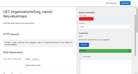

 With the API I get this kvm called "privacy":

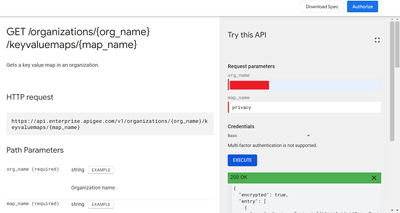

And I can access the contents from this "privacy" kvm:

Correct (mostly).  In Apigee Edge, KVMs have a scope, one of organization, environment, or proxy.
The UI snap you showed, queries the environment-scoped KVMs.
The API you tried, queries the organization-scoped KVMs. That's why you see different results. If you want to use the API to retrieve environment-scoped KVMs that you need to use the URL
https://api.enterprise.apigee.com/v1/o/:ORG/e/:ENV/keyvaluemaps
The reason I say the above answer is "mostly" correct: The URL offered there is for Apigee X, not Apigee Edge.  Apigee X does not have organization-scoped KVMs, nor proxy-scoped KVMs.  So the response above is correct, in that you need to add the environments/ENV segments to the URL path. But not correct in the basic endpoint.  apigee.googleapis.com applies only to Apigee X and hybrid.  api.enterprise.apigee.com works for Apigee Edge.
