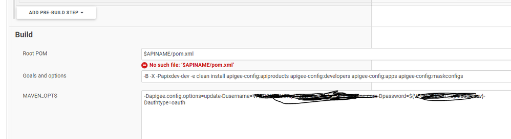

[APINAME] $ java -Dapigee.config.options=update -Dusername=sso-machine-user -Dpassword=[*******] -Dauthtype=oauth -cp /var/SP/data/jenkins/maven35-agent.jar:/var/SP/data/jenkins/tools/hudson.tasks.Maven_MavenInstallation/M3/boot/plexus-classworlds-2.5.2.jar:/var/SP/data/jenkins/tools/hudson.tasks.Maven_MavenInstallation/M3/conf/logging jenkins.maven3.agent.Maven35Main /var/SP/data/jenkins/tools/hudson.tasks.Maven_MavenInstallation/M3 /var/SP/data/jenkins/remoting.jar /var/SP/data/jenkins/maven35-interceptor.jar /var/SP/data/jenkins/maven3-interceptor-commons.jar 32232
<===[JENKINS REMOTING CAPACITY]===>channel started
Executing Maven:  -B -f /var/SP/data/jenkins/workspace/jenkins-job/APINAME/pom.xml -B -X -Papixdev-dev -e clean install apigee-config:apiproducts apigee-config:developers apigee-config:apps apigee-config:maskconfigs
Apache Maven 3.5.2 (138edd61fd100ec658bfa2d307c43b76940a5d7d; 2017-10-18T08:58:13+01:00)
Maven home: /var/SP/data/jenkins/tools/hudson.tasks.Maven_MavenInstallation/M3
Java version: 1.8.0_112, vendor: Oracle Corporation
Hello Sai,
First one is the profile from settings.xml and second one is maven command executed by Jenkins. Below is the complete error output I can see on console

In your call - Are you trying to generate a token outside and pass that to the job or you want the plugin to generate the token ?
As of now plugin is genrating the token. I tried with genrating the token outside and poplute the -Dbearer parameter but it was not successful.
Can you share the maven command how your Jenkins is calling it.. (from your Jenkins file)
Hello Sai,
It is a maven project, we are not using jenkinsfile, but, in one of the above code blocks I have shared the command jenkins is using.
you have shared the logs from the execution. And that log has the maven command called twice.. So please share the exact mvn command being executed
Maven command: Executing Maven: -B -f /var/SP/data/jenkins/workspace/myworkspace/repositoryname/pom.xml -B -X -Papixdev-dev -e clean install apigee-config:apiproducts apigee-config:developers apigee-config:apps apigee-config:maskconfigs
Hope you have space between the arguments in the MAVEN_OPTS
yes sir. :-). invalid opts will fail the job
