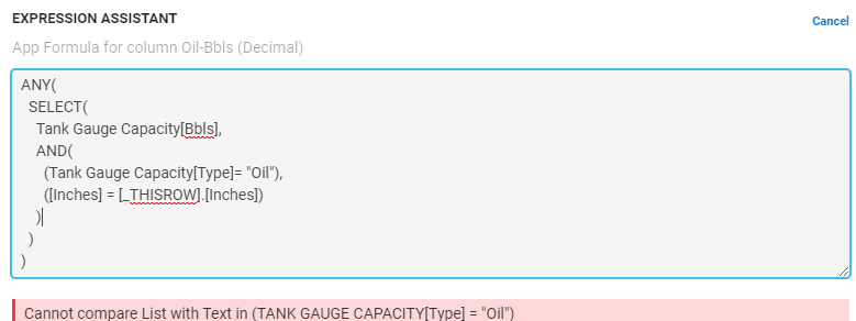

Thanks @Steve
I tried the solution you provided
Gives me an error
That is not the expression I provided.
@Steve
Using the expression that you gave, I get the following error. So I tried to correct the error and ended using the modified expression

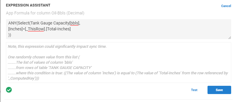

I am using the expression as below
ANY(Select(Tank Gauge Capacity[bbs],
[bbls]=[_ThisRow].[Total-Inches]
)) in Tank Guage Table for Oil,bbls
So its probably returning a blank result then. The formula is valid, but not finding the correct figure
I believe that it is returning Blank result, I am stumped

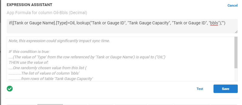

I have got this to work almost there
Now this condition is to be satisfied, [Tank or Gauge Name].[Type] = “Oil”
