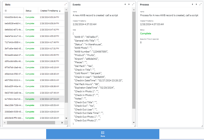

This is what I see from the Monitor.
So the monitor logs that the bot was initiated and that the bot completed vs failed. So does it actually complete your Process which appears to be a script? Or are you asking why does it execute at all since the app is in prototype mode?

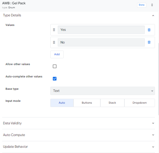

Your screenshot of the Enum column doesn't show what the Basetype is. Can you show that? I am wondering if there is a mismatch on the "Yes" which will be interpreted as text, so if the Enum YES/NO basetype is not text, then that could be a problem.
The Base type is "Text".
Also, I have an Initial Value of "No".
Just thought of something to try. Uncheck the 'Auto-complete other values' in your column setting. I seem to recall that this setting has presented some problems for me in the past.
I unchecked the "Autocomplete other values", but nothing changes.

Your screenshot from the Monitor clearly shows that the selected run has
"Gel Pack" :"Yes" ?
The bot will just run every time you add an entry but since you opened the 'Test' button, this will always show TRUE because it meets the condition of your event.
