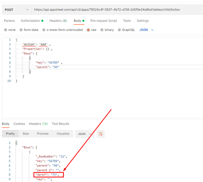

I am finding that when I add rows through the API in automation, the de-references on newly added rows are not working.  The REF value is there and I can use it in SELECT's to retrieve additional values that way but I cannot seem to de-reference through the REF column directly.  If I edit the row right after the add to force a re-calc, the de-references work then and I get my expected values.

I do not encounter any issue with using dereferences when adding a record via API. I just tested it on my test app too.
Are there any extenuating circumstances in your situation? For example, maybe a security filter that is different per user, so when the API runs as the app-owner user it can't see certain records?

Thanks Marc!  You were spot on.  Removed security filter and now I get expected results.  I don't think Security Filter is need any longer anyway.  I don't think I would have figured that part out.
