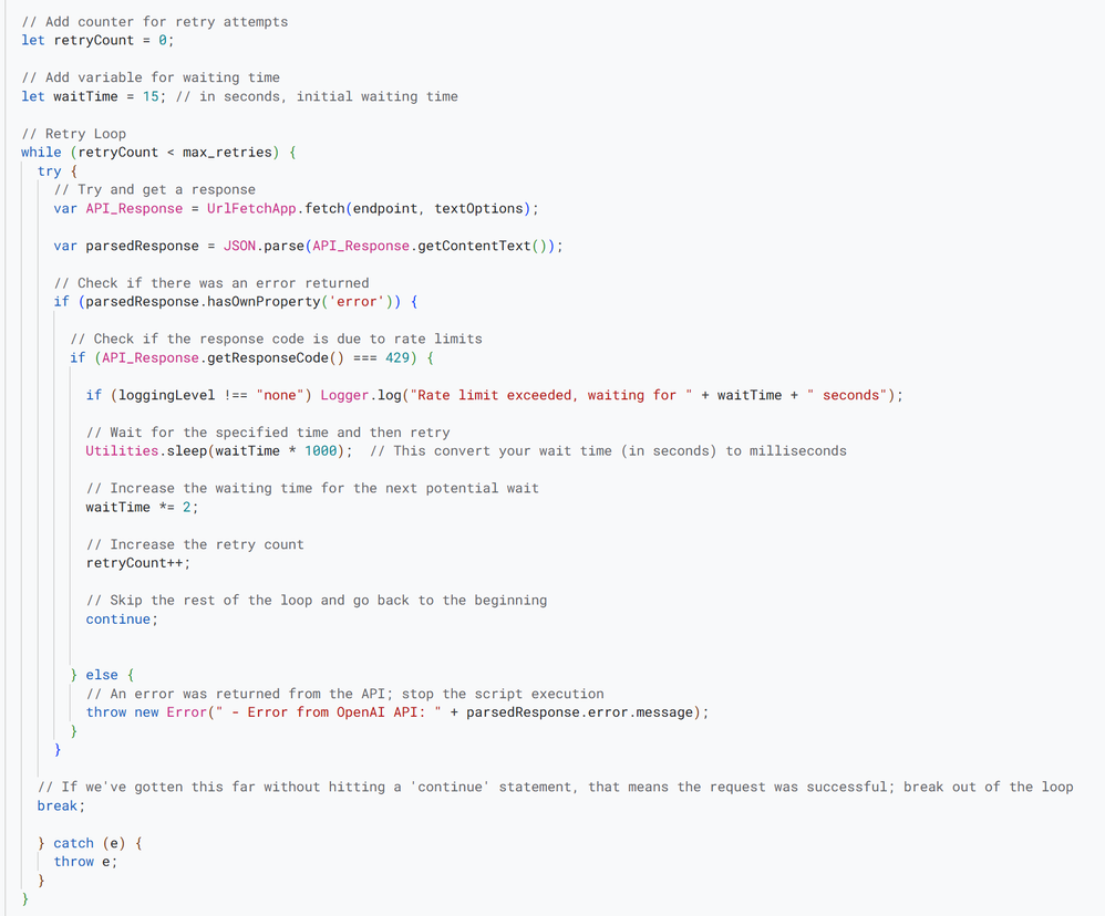

Maybe try and implement an exponential back-off - I've found that this smooths out these little hiccups.
What is this?
It's a way of handling certain transient errors; here is an example that I use when retrieving responses from OpenAi

Here’s a quick primer on exponential back-offs for scripting:
What is an Exponential Back-off?
An exponential back-off is a strategy for handling retries in scripts when an action, such as an API call or network request, fails temporarily. Instead of retrying immediately, which can add strain or waste resources, the script waits progressively longer between retries.
How It Works:
1. **Initial Attempt**: When a request fails, instead of retrying immediately, the script waits for a small initial delay (e.g., 1 second).
2. **Increasing Delay**: If the retry fails again, the delay before the next retry is increased exponentially. For example, the script might wait 2 seconds after the first retry, 4 seconds after the second retry, 8 seconds after the third, and so on.
3. **Max Wait & Retries**: You set a cap on the maximum delay (e.g., 32 seconds) and the number of retries, so the script eventually stops trying if the issue persists.
Why Use It?
- **Reduces Resource Usage**: Prevents overwhelming a server or service by spacing out retries.
- **Better Error Handling**: Gives time for temporary issues (like network blips or server overloads) to resolve themselves.
- **Improves Reliability**: Makes the script more resilient to transient failures, which are common in network interactions.
Usage Notes:
- Make sure to set realistic limits for delay and retry counts.
- It’s ideal for handling temporary issues, but persistent errors need a different approach.
This approach is common in networked systems, cloud-based scripts, and APIs to improve script stability and robustness.
