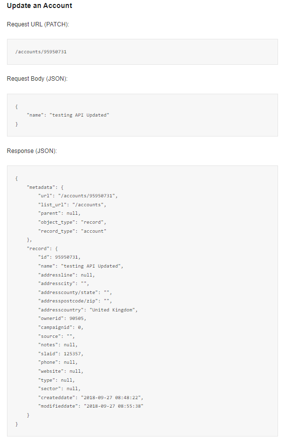

You have to make PATCH request to the server i guess. Please see the screenshots from their API Documentation below

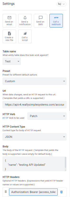

To get started, you can create an Automation in Appsheet to Call a Webhook as shown below. Feel free to ask if get stuck
